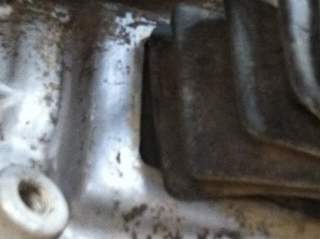

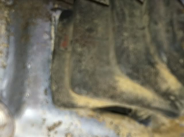

So I crawled under my toy after I got my replacement parts and I noticed that the rubber boot that goes in the the trans is pulled out and not sealed. How much damage is done inside where I can't see lots little none? I am going to put my slave and master on today. But I would like to get some experience on what if anything I can expect to fix next.

With a touch it just popped right out

i dont even run that little rubber boot,mine disintegrated during a trans swap. It holds nothing in, it just keeps dirt out. Replacements are easy to come by and if you get one you should be able to get it in there fairly easily without taking anything apart. easier still if you unbolt the slave.

you can get one here, if you decide to pop in some fresh rubber.

Mines melted my dad replaced his and the new one didn't fit my moms is in peices and nothing bad has happend yet so I don't figure its gonna hurt nothing
