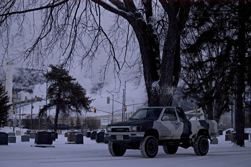

well layout is what you like...i made my own...also made a couple more...what do you like....winter...desert...forest.. Paint I used krylon grrey black and white.... I first painted it white where it should be...let it dry...masked it off..sprayed black and so on

haha indeed....and it was like 3 cans of each.. and i have 2 white left...1 black and 1 grey...and I did about 4-6 layers each

Old Jan 4, 2008 | 02:41 PM
Albert.G's Avatar
Joined: Jul 2007
Posts: 429
From: Thunder bay Ontairooo
its vinyl

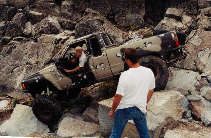

This was about 7-8yrs ago but Krylon camo Tan, Brown, Black and Flat White.
Not taping the edges of the different colors. It looked better to me than having hard contrast....probably about 4 cans of tan and brown, 1 of black and white.
I layed some desert camo pants on the driveway and compared occaisionally.
I did the tan first, then added brown where I thought needed it to be broken up. Then painted white spots randomly but it seemed to look good if I had a larger glob with a couple small ones around it. To do them I held the can as close as I could without getting runs. Then came back and added black as shadowing to the white and it was the same thing to apply, as close as possible without runs.
I got it to shine with wood polish, which would last about a week. I have also heard of Mop n' Glow working too.
It worked well, I actually broke in the at Sand Mtn. once and got a ride to camp and it was dusk when we came back and couldn't find it until we happened upon our own tracks from when we left.
The truck is long gone but still one of my favorites.
Nick
