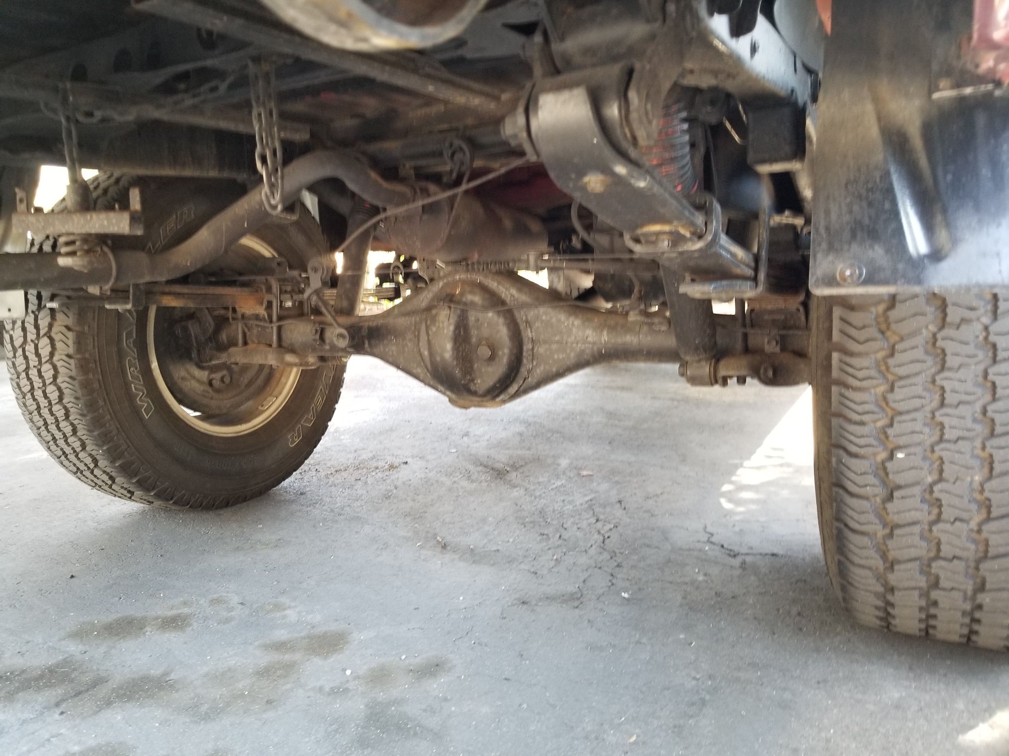

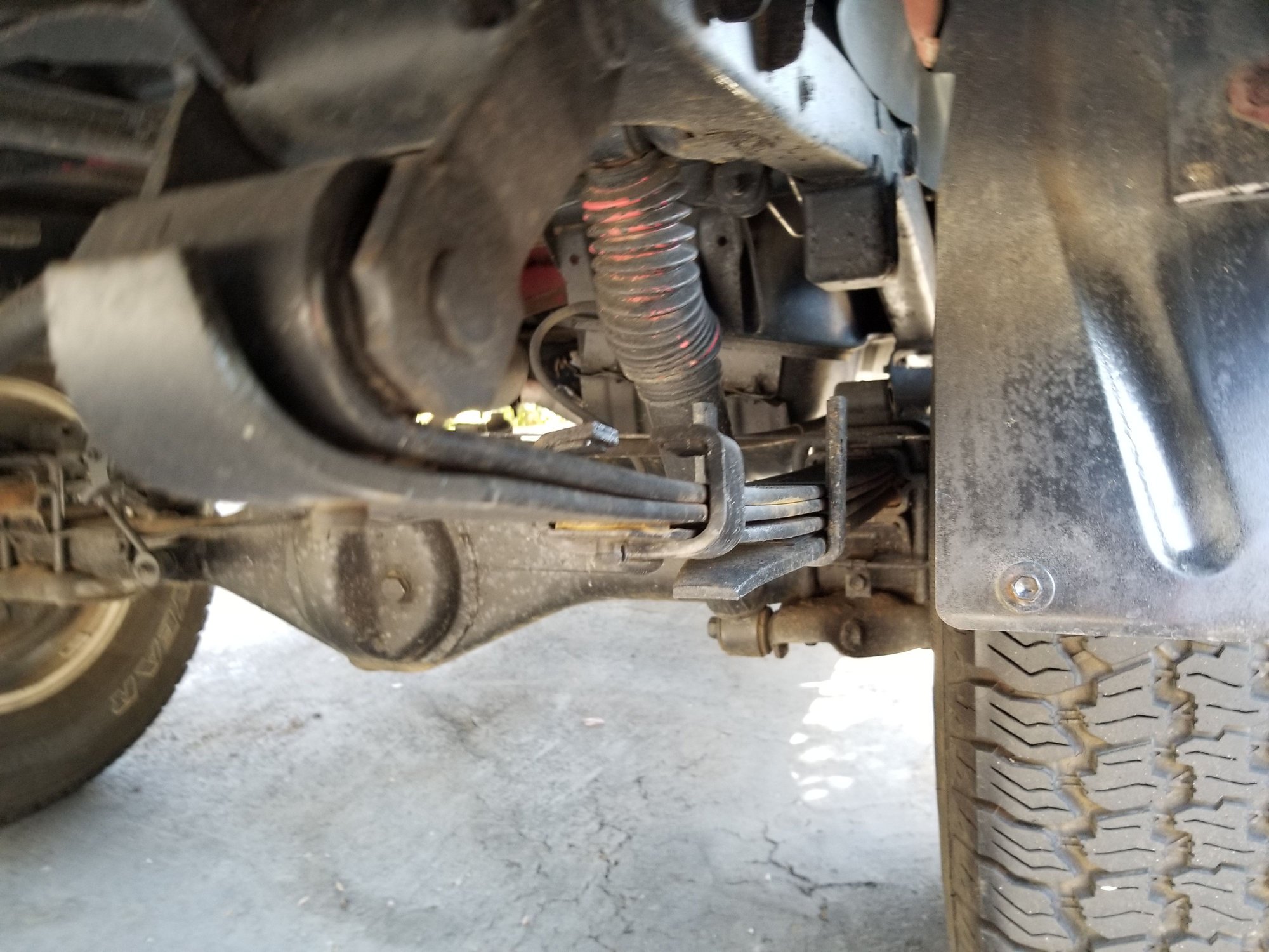

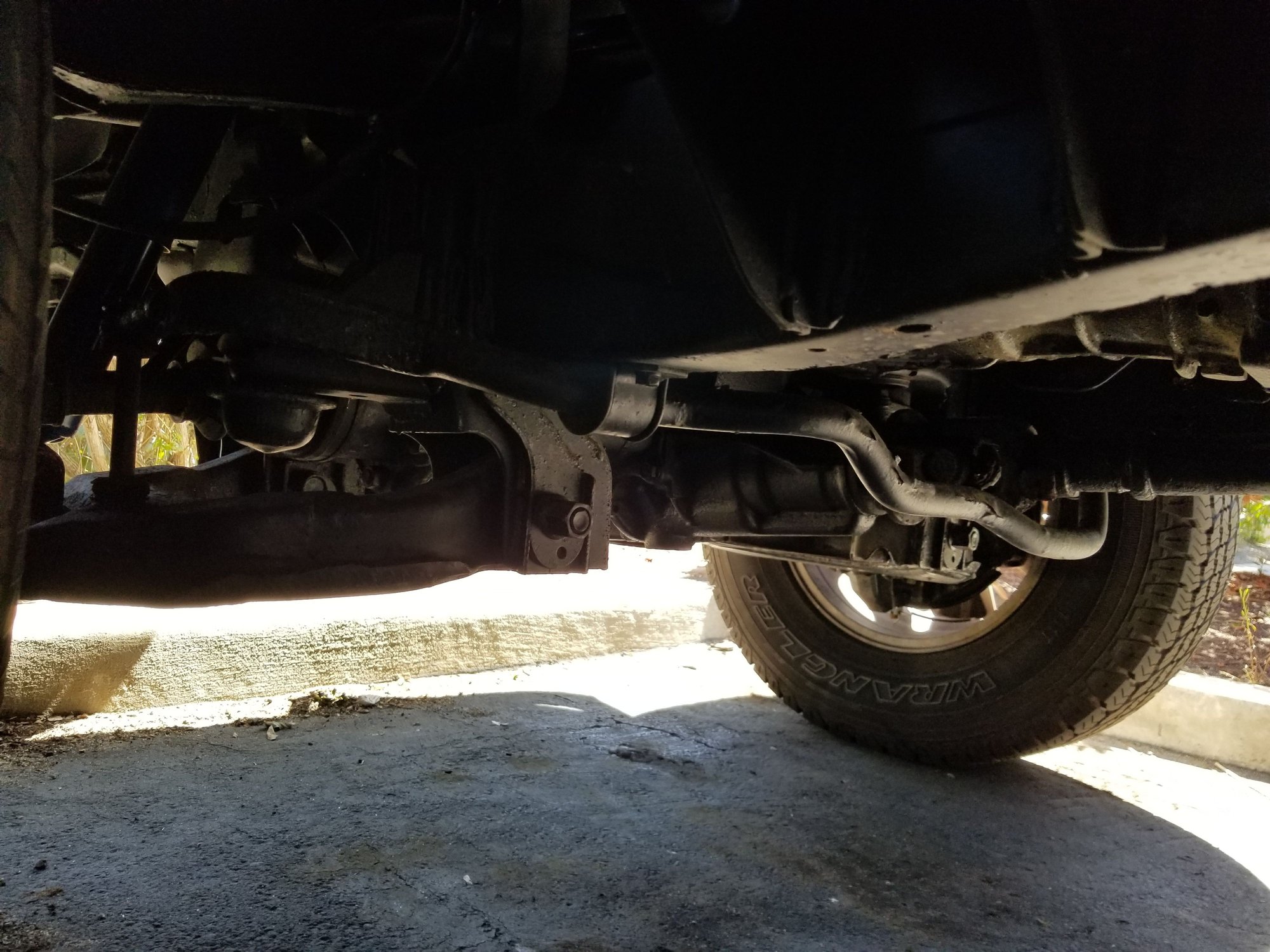

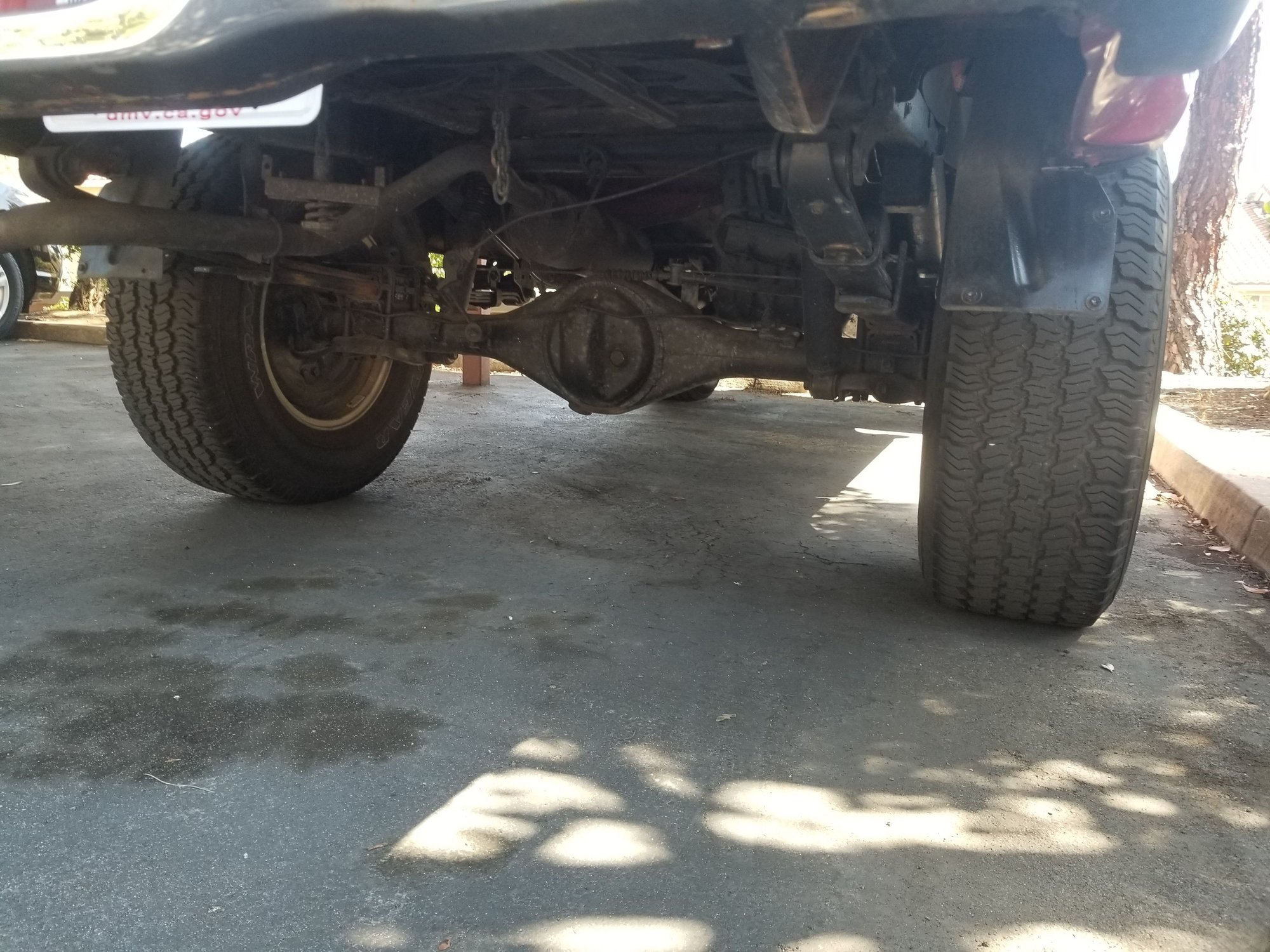

pictures
1. I dont think I have IFS but I could be wrong.
2. What are helper bags?
3. Pictured are my springs.

So, 1.) You DO have IFS. That stands for "Independent Front Suspension." It doesn't have a solid axle like the rear.
2.) Helper bags and basically Air springs that would be installed on the top of the spring in the center (Where the axle is located) and then mounted on the top side to the frame. You inflate them to increase your load carrying capability. These work great in that when there's no load you can deflate them some and they won't ride horribly. A replacement leaf spring designed to haul extra weight like you want will ride very harsh without that weight.
3.) Those appear to be factory springs. I.e. They're going to sag with 900lbs in the back.
