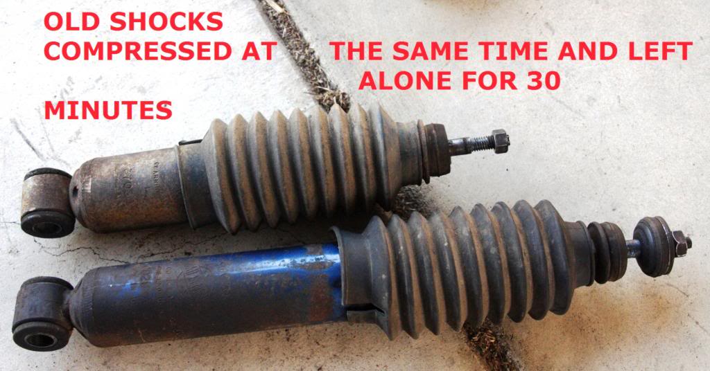

ON mine, as soon as I removed the old shocks, it was obvious one was really bad...

Cool. How did your old ones look like? Did they compress and extended after a while or did thy stay compressed?

O man, they didnt move when you try to cycle them..they would cycle but wouldn't go back

Good to know. Yeah, guess that's one practical way to test the shocks- actually taking them off.
