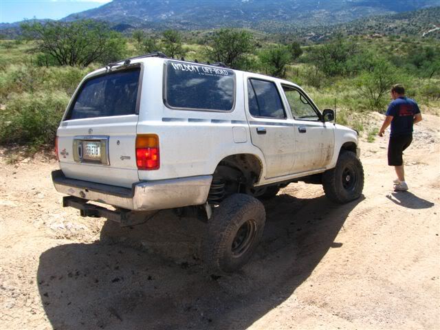

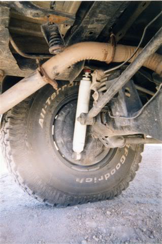

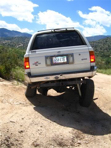

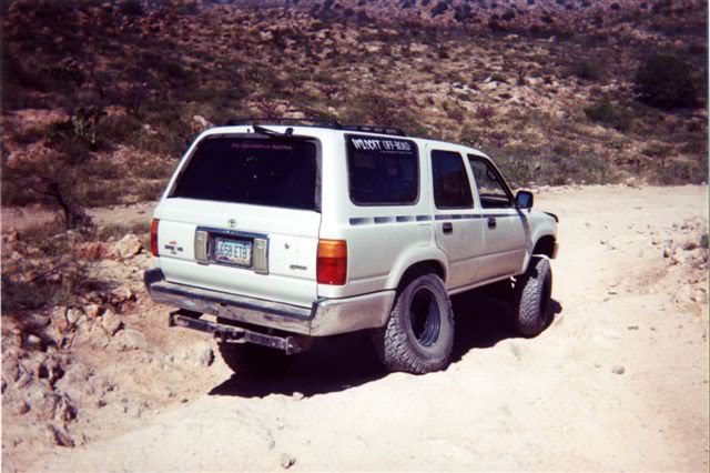

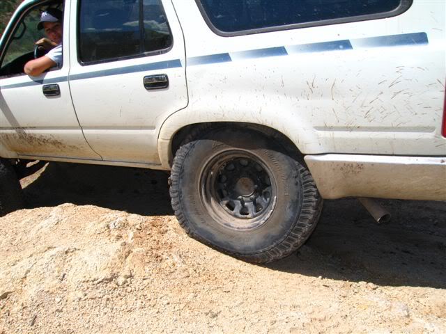

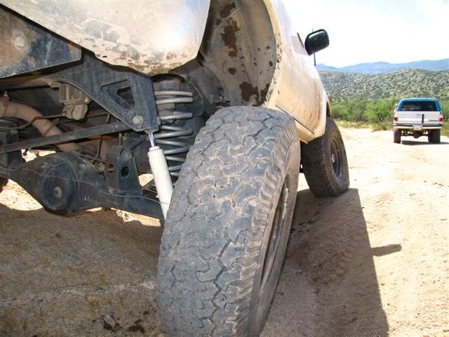

Old Apr 1, 2008 | 12:14 PM
mastacox's Avatar
Joined: Dec 2003
Posts: 2,893
From: Fort Worth, TX

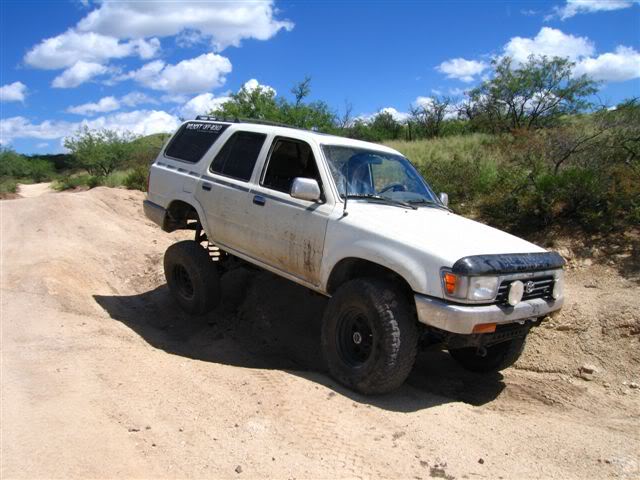

I'm still using those RSX shocks you found in that post I made a long time ago. The rear bump stops are stock, and I carefully measured my max compression before buying them so I don't have any problems over-compressing them AFAIK.
In the front I have ultra-low profile poly bumps for the compression, and low-profile for droop. Most people recommend that you leave the stock bumps for the droop as you may droop too far and damage a CV, but I have had no problems.
Some pics of front and rear flex (I also have swaybar disco's front and rear). All of the pics are pre-ball joint spacers, tires are 33x10.50r15 BFG A/T's:
