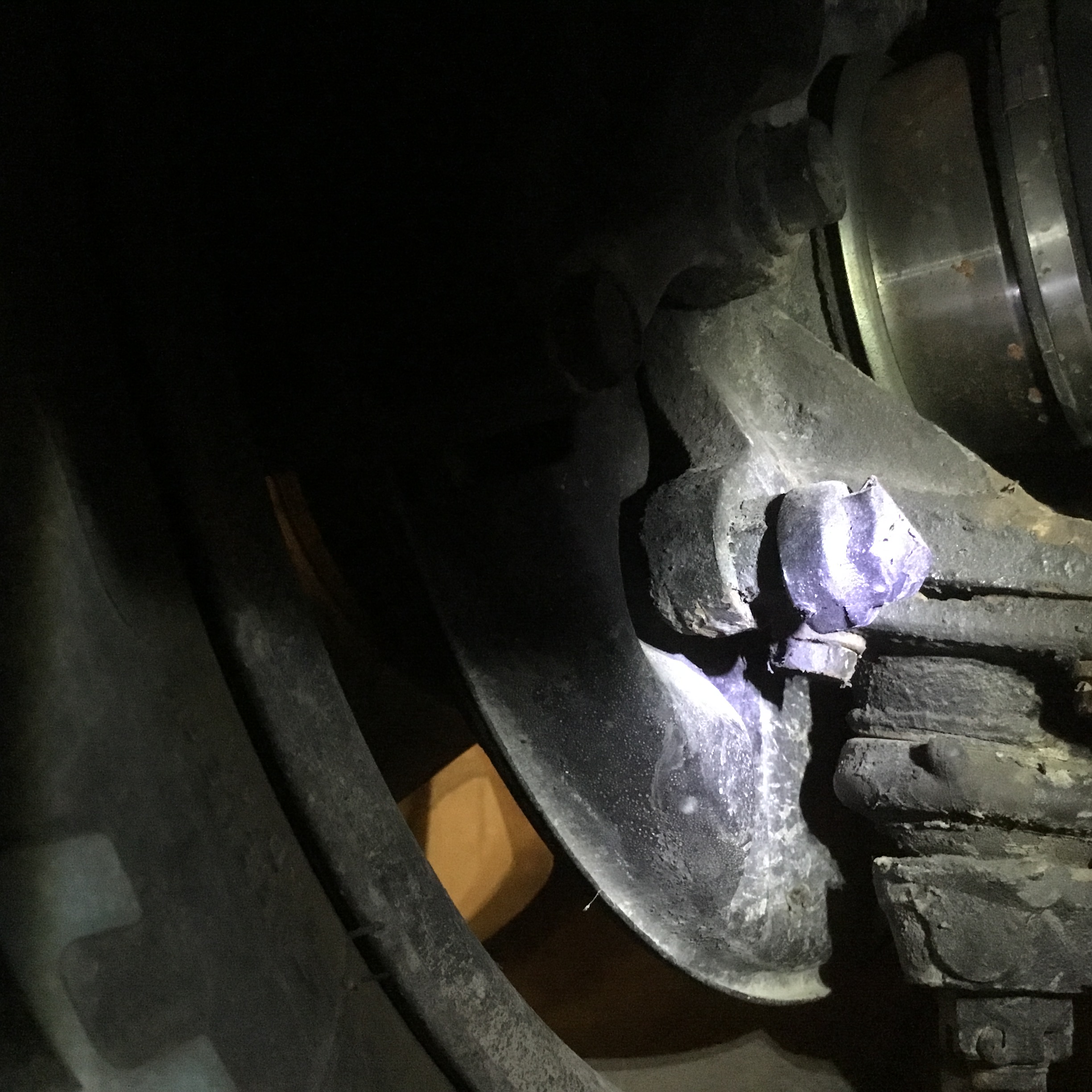

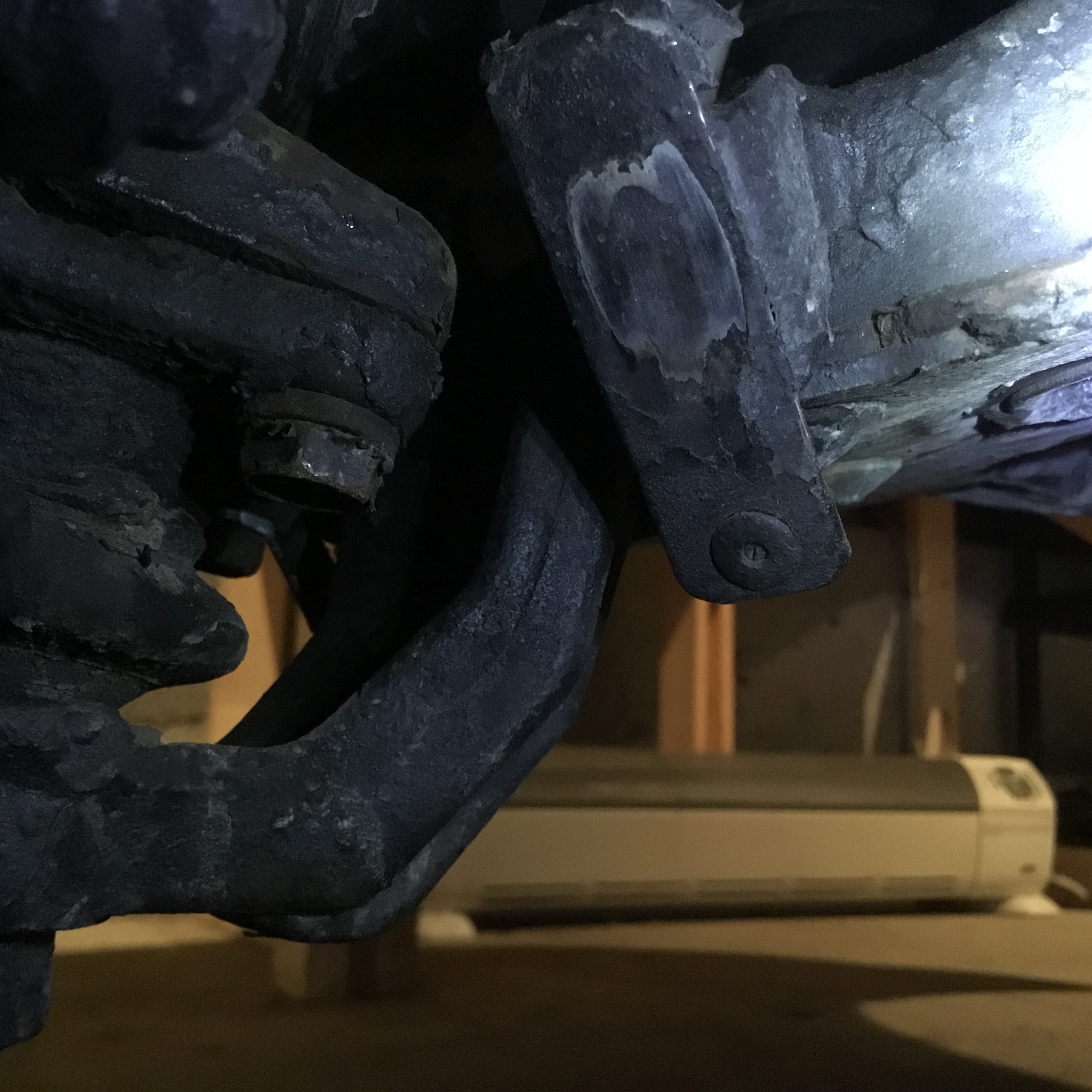

I read enough about steering stops, idler arms ball joints to sink a ship. The original problem is that when turning sharply, or while jumping a curb, the front end of the pickup makes a horrible grind/thunk sound. I've taken a few photos and believe that is it my steering stops. If someone could confirm this that would be awesome. I've attched a few rough photos but hopefully you can see the bolt gound down against the other surface. Any tricks another than slathering grease on each contact point? Not sure what the heck prompted, or why, the two contact points to started to grind against each other. Thanks.

yeah, ignoring ugly sounds from the front of the truck is easier said than done. From my research, I agree that there seems that not much that can be done. However, it's hard to believe two metal contact points will inevitably rub or grind against each other, without the possibility of repair. It's so crazy, my steering stop seems to have a gouge taken outta it. Hmm... telfon you say.

When the steering is at full lock, the front IFS can still flex, so it's rubbing on the steering stop. Most people call that sound a "groan." So the part provided by Toyota is called a (wait for it ...) groan stopper. http://www.partsgeek.com/ss/?i=1&ssq...066171&x=0&y=0
They're not real cheap, but they really do work a whole lot better than just grease. They will last a long time as long as you follow "Doc's" advice -- when you hear it, back off!

Groan stopper, that's too funny, although intuitive to the problem it is solving. The bolt that has had the rubbing is somewhat ground down/angled (pics kinda show it), is it necessary to replace them in general or prior to the groan stoppers being put on?

Your pictures show your busted-ass existing groan stoppers. I wouldn't be surprised if they died for the cause and your bolts (underneath) are fine. Just pull off the old ones with a pair of pliers, clean everything up (too much grease underneath will keep the replacements from seating), and tap on the new ones.
Yeah, a dab of grease on the outside of the new groan stoppers won't hurt, but I don't think it helps much either.
