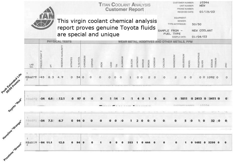

I'm on fence concerning old green vs. Toyota Red, but they take different approaches. More is involved than color. I found this:

A 50/50 mix of fresh toyota red & distilled water has a pH of 7.3, so I wonder if they mixed up some of the numbers between the red and the Havoline?

From that chart, it looks like the Havoline Orange would potentially be the least corrosive, due to the mutually agreed reasoning that you want to have a relatively stable pH range, with little fluctuation.
Interesting that the Havoline Orange also has an EXTREMELY small portion of Sodium compared to the others.
This being said, I seriously doubt, me switching to either of these will make any difference at all(other than the size of the dent in my wallet) at 200,000+ miles.

Well I can't say I understand the point but I will say that different coolant types have different pH ranges. 9 is in the range for Prestone green, not Toyota Red which is a mild base at just above neutral (7). Corrosion actually increases in higher alkaline environments, not just in lower acidic ones. Most modern coolants have pH ranges near that of Toyota Red.
Havoline orange is Dex-Cool - the OAT involved in all the class action lawsuits for engine damage. Its 2-EHA-based chemistry is highly corrosive of lead solder and a very poor choice for vehicles with lead/copper/brass radiators & heater cores.
Sodium in antifreeze comes from various metal salts used as corrosion inhibitors. Sodium silicate being the main one in Prestone Green, and Sodium Borate and Sodium Molybdate are two others sometimes used in conventional and HOAT coolants. OATs and HOATs use organic acid salts as their main inhibitors, though, as mentioned, HOATs also add some inorganic salts, usually sodium silicate. Toyota Red uses sodium benzoate, an organic acid salt, as the primary corrosion inhibitor.
The chart appears to have a number of contradictions, so I don't know whether anything can safely be concluded from it. At the top it says it's a virgin coolant analysis and for new coolant. So it would not have any wear metals in it to show how much corrosion occurred with any of them.
All these coolants use ethylene glycol as the antifreeze, so the freeze point should reflect the glycol percent. Yet the freeze points shown for every sample are wrong based on the glycol percent - not one of them is correct. The pH of the Toyota Red sample is wrong, but as mentioned in the opening post that is probably because conventional pH testing doesn't work in pure glycol - you have to mix it with water to get an approximately accurate reading.
