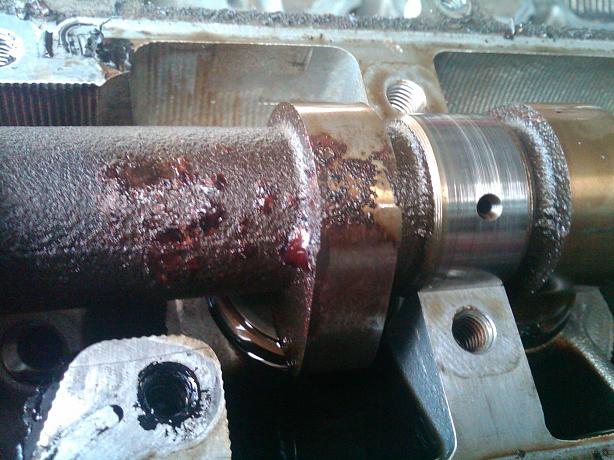

hi everyone, I am pulling my engine apart to do a hg job on it but I noticed the camshafts are rusty. I was wondering if I can take the rust with some fine sandpaper or if I have to replace them?

i have used REAL fine sand paper on some rusted ones but not that bad. that one looks to me like its to far gone.

Great excuse to get a new cam!

From the picture you've shown, the rust is on the back side of the cam lobes. It's not a big deal from the perspective that this part of the cam doesn't contact the cam follower / shim, but it is a big deal because it's rust and once rust starts it doesn't stop. The PO kind of screwed you there when the engine was left with a lot of moisture in the crankcase, which lead to the rust. If you don't change the cams, that rust will progess, particles will flake off and get into the oil, maybe even flake off and gouge the cam lobe(s) and shims before getting into the oil. See where I'm going with this?
I suggest you replace the cams. Or at least clean the lobes up with emery cloth then have the cam's checked to make sure they still have the correct lift, etc.

well something come up so I am going to take off the rust with sandpaper...wish me luck....I am planning to rebuild the engine in the future...

oil, and very fine grit sand paper...

could you bead blast it?

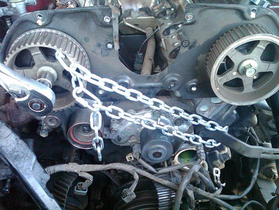

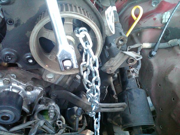

I was having trouble on how to loose the bolts for the pulleys but I saw someone doing it here at toyatech. I worked great. and cheap too

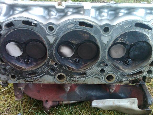

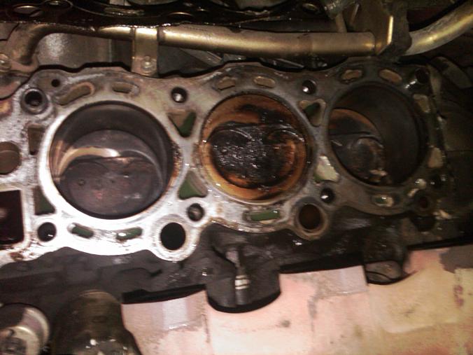

after a few hours of trying to get the crosspipe's nuts off, i finally got one of the heads off and look what I found.....passenger side head and piston....look at the head gasket....the guy told me they put something in the radiator to seal the gasket but two weeks later got worse.....looks to me they put mod ...

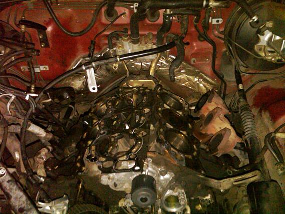

later that day I got the other one....it was kinda later but decided to take some pics any ways

ok a little update on this tread, I clean the rust off of the cams with very very fine sad paper so wish me luck...
