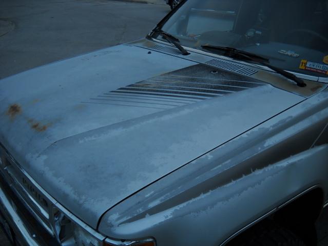

Moved from Cali to North Carolina and bam me too.... So here's my worry...
I get that I need to grind/sand down shinney and treat the spot and paint over it but, it's my beater ( I love her, but she's my beater) some day I will give her a proper paint job so I want to make sure that I can spot paint/primer the trouble spots but it won't screw up the real paint job I get some day. Like the spot showing through real paint or real paint not adhearing to what I treat it with.
What should I use so it doesn't mess up any future pro do I get latter?
Attached Thumbnails Rust under paint-hood.jpg   Rust under paint-hood-one.jpg   Rust under paint-rust-one.jpg

what is a phosphate rust converter? can I get it at a parts store? I have some rust similar to what HELIDRIVER has.
Off the topic, from the picture, I notice you have a base sticker for cherry point, nc. I was in the Marine Corps many many years ago and stationed at cherry point, nc.

Semper Fi, hate it hear can't wait to get back to the west coast...!!!!! For the rust issue too
So question about the rust converters will that interfere with a future pro job?

yeah, i think i just got to hit it with some sand paper, it's only on the surface. rust converter it and hit it with primer. I just don't want her earning the name "patches" here on base until "someday" when a pretty black will become a priority....
