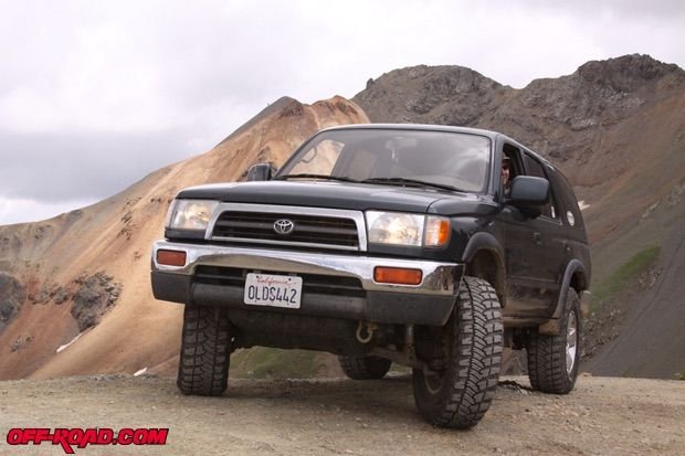

I am running 265/75/16 on mine. Any smaller and the lift would look a little weird. I have the 881 and 890 with bilstein 5100s around. Front are bumped up to second notch for abkut 3 inches total. I have seen a lot of guys running 285/75/16 but you may need a 1 inch body lift to prevent rubbing. Others say they don't rub without the body lift. So I guess it depends in the tire. Maybe someone else will chime in. But I would just Google ome 881 890 tires 3rd gen 4runner. You will see a lot of answers. Mainly on t4r.org. here's a pic of mine. I think when it comes time I will just go with a mud terrains and rims with a different offset to get me more flush. I like not worrying about rubbing.
