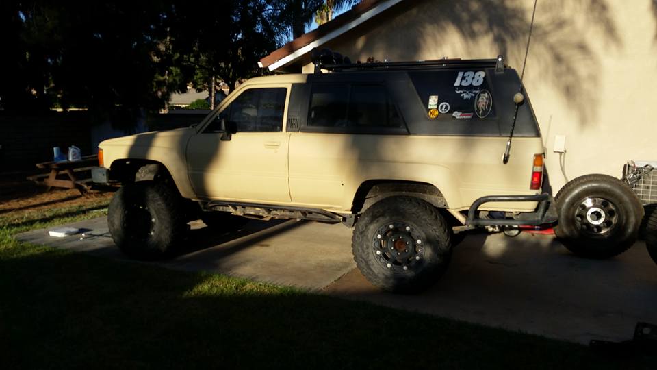

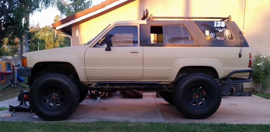

Ok so got the Pro Comp alloy wheels mounted to the General Grabbers 35s.
Just wanted to do it to see how they look and ride.
With the 4.88s I like it on the street. When I would take off at a stop with the 33s would go through 1st way to quick and have to shift. Also doesn't *seem* slower but I just drove around town no real uphill or anything.
The 35s did rub when I would turn the wheel quite a bit and pretty bad pulling into driveways. Thats ok Blazeland Kit is paid for and Deaver is working n the mini pack. Soon it shouldn't rub.

Old Aug 29, 2015 | 05:07 PM
dirtdobberoffroad's Avatar
Joined: Aug 2011
Posts: 654
From: Swamp east MO
Looks good with out the blazeland and deaver packs just needs a little trimming!!
Thanks man, would actually need quite a bit of trimming to wheel it as I've been rubbing pretty good just around town.
