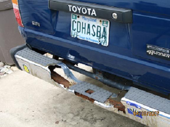

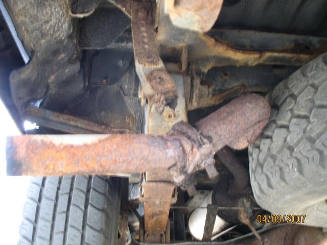

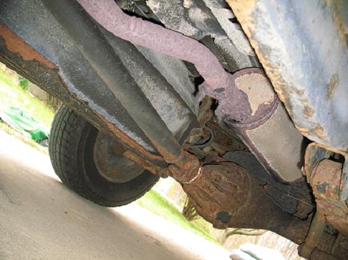

first thing i wanna say this site is awsome, good work to everyone who created this site.
now im looking at a 86 4runner that my nieghboor is selling me what i really need is expert advise and opinions about wheather or not i should buy this truck so any help would be great, heres what i can tell you about the truck:
*he s selling it to me for 1000
*it has been inspected, it needs a new parking brake, new back brake pads, something with the exaust system and needs a ding in the windshield filled in totaling 500 in repairs to pass inspection
*they said that the bottom was preety rusted i dont think it looks bad but see what you think
*it has 130k miles (original)
*it has new tires with only 100 miles on them
*a new muffler
*the seller is the origingal owner
*has not been taken off roading and has been maintained by one mechanic
*it has new speakers
now thats all i got so far but ill try to answer your questions thanks again for your opinions and advice one thing i would like to say is that this is my first car and i am a junior in highschool and i would like to have this truck last me through college and i dont have alot of money so i cant be shelling out money every weekend to keep it running. heres some pics to help you guys

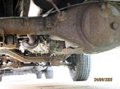

here is some more pics

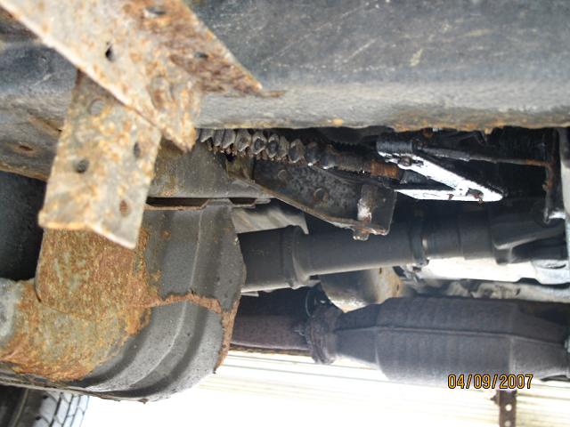

even more

Old Apr 10, 2007 | 08:44 PM
91TPU's Avatar
Joined: Oct 2006
Posts: 1,589
From: NorthWest NJ
well i must say, that is a significant amount of rust...i dont know if i would be willing to pay 1k for something with that much rust
first off im assuming that the new muffler isnt installed yet, cuz the one that is on there is beat...it does look like it has a somewhat new exhaust manifold on there tho...also it looks like its leaking something, im assuming engine oil, cuz the front diff is covered in something along with the back of the tranny...
if your willing to do a lot of work to combat the rust, replace some parts, and really get your hands dirty, then yes i would say buy it, but not for 1k...if your looking for something thats gonna be super reliable, then i dont think this vehicle is for you
