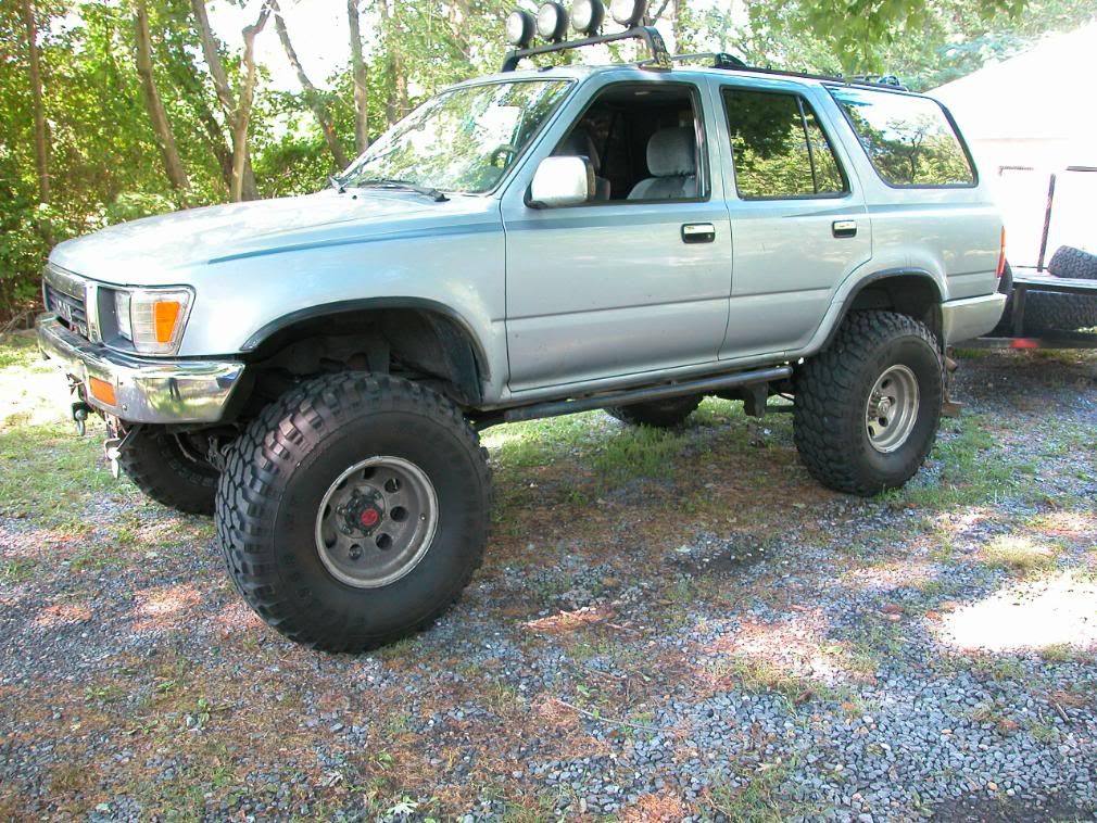

Originally Posted by olharleyman
Looks really good did you put a 2" body lift on it? any t-bar turning? Also is yours automatic or 5 speed? Never mind I see it is a 5 speed again it looks really good
I just have 4" lift kit procomp stage II, 1.5" TTB, 5 Seed and 4.88 gears... i'm planning to install 2" or 3" body lift and 5.29 gears in a future....

Getting the lift right
Great lookin' rig man, just to confirm you have a 4" suspension lift - and you're using a set of 6" coils in the rear to get a more even lift front/back correct?
