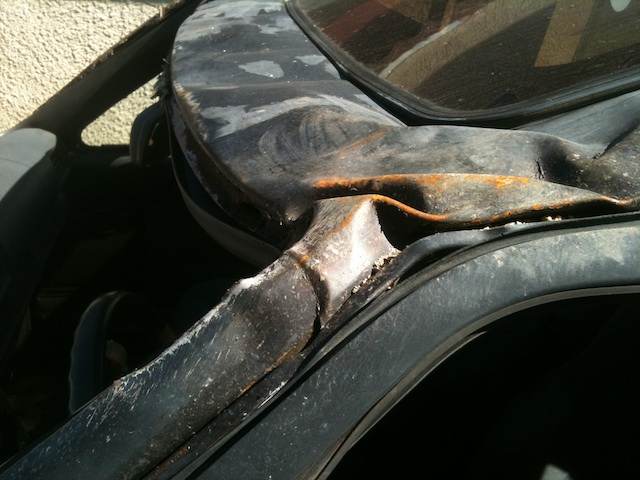

When taking out the shattered windshield off the old cab, it looks like the body was pretty much toast. Rusted completely through a few parts where the glass sealed to the body. (no everywhere in socal is rust-free), so i may end up in a better situation than i was before.

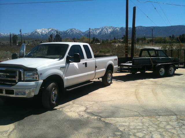

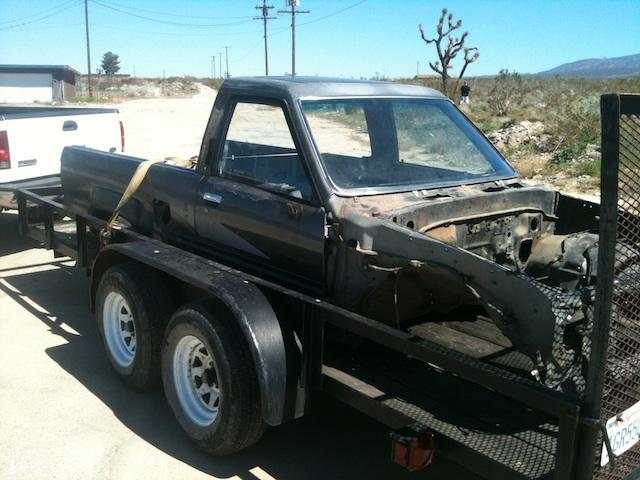

So picked up the new body today. And got to say I am extremely happy. The pics don't do it justice, but this cab is nearly flawless. no dents, minor rust around the battery tray only, even the windshield and door glass looks great.
