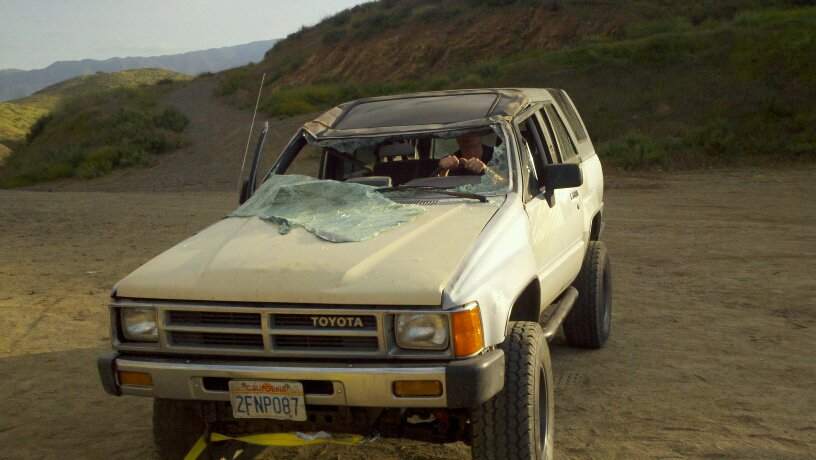

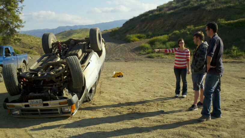

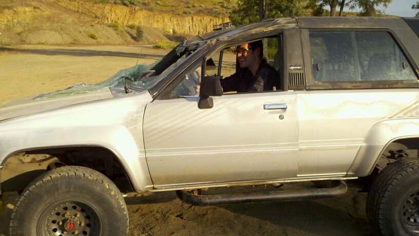

Well just finished putting on all new ball joints, shocks, and lca bushings. Decided to turn around quick on a wide open flat dirt area...wheel grabbed a small divit, crappy tire fell off its bead....and I set her up on its roof.
Luckily the girlfriend and me were fine. minor cuts and scrapes. The 4r didn't fair quite as well.
What do i do now? Couldn't get the engine to turn over, but it sat upside down for about an hour before I could get enough guys out there to flip it back over. I think the cylinder's may just be full of oil...(will try to crack..but only gets about 1/4 turn before getting hung up.
I found a local (2 hrs away) guy, parting out an 89 v6 at (mines an 87 22re mt) who is letting go of the body, doors, and fenders for $500. I just wasn't sure what the big differences would be between the years, and being a v6 vs 22re, and at vs mt (besides the wiring/computer.)
Attached Thumbnails Rolled her :(-191897_10150119032187051_575707050_7105056_8349990_o.jpg   Rolled her :(-204729_10150119001182051_575707050_7104671_6896960_o.jpg   Rolled her :(-209398_10150118810542051_575707050_7102173_3294409_o.jpg
