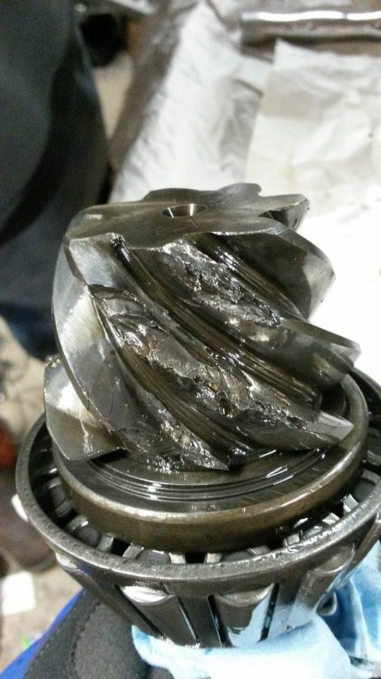

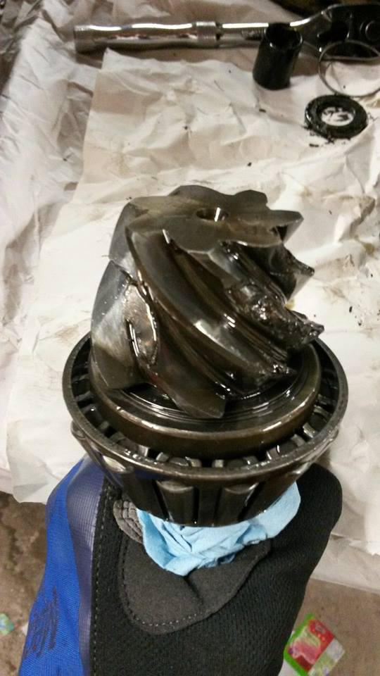

just a little update.. due to fund availability and transportation I was unable to get my current 3rd set up because lack of tools (expected) but what hurt worse was being unable to get around to work and everything with the 3rd removed.. basically I had the 3rd put back in minus the old drive pinion and sealed the hole so it could still hold fluid.. this went on for about 2 months till I had just enough to buy a used 3rd with the 4.88 gears I wanted in them already, Yukon brand. so I finally got that all done yesterday and installed not Ive got to get my other 3rd fixed as a backup... here the thing I have to ask.. my original 3rd has lockers inside and I haven't done enough research on them to know much about them but can anyone explain some advantages to them?? I'm just glad I can get the original 3rd in the shop without being done the only vehicle we have... I've already got all the bearings and parts to do the 3rd I had originally and was wondering whats a decent price for someone to set them up correctly ready to pop in as a backup??? all parts I already own and only thing that needs to be done is thrown back together minus bearings being pressed as Ive already had those done except for the drive pinion. So far I really like the way the 4.88 feel in my truck... seems to be a lot better as a daily driver compared to my 5.29 gears I had before... next mod I plan to do is the supra 7mge air flow meter... I hear this ones real nice if you calibrate the meter correctly...love my multimeter and knowing how to actually use one lol..also attached some pictures of the old drive pinion out of my original 3rd..

I guess I am confused...previously you said you had all the necessary tools...now not?
Lockers = traction
..tons of info on it..search

we had all the tools at my buddies house, press and everything. but its such a hassle working around his schedule during the winter and being without a 3rd while waiting... just one of those things ya know.. lockers was just a extra question. I just wanted to update this as I left it open as it was unfinished.. Im actually ready to get my original done with the lockers.. I also think the 3rd I got was from a 2wd due to the difference in the 3rd housing...any ways to tell?

2wd's have a 7.5" ring gear. I forget what years had different thirds or what designates the difference in thirds. You could have gotten a third member from a 4 cyl truck since yours is a V6. 4 cyl have 3 ribs V6 has 4 ribs. 4 cyl is a 2 pinion and v6 is 4 pinion diff.
