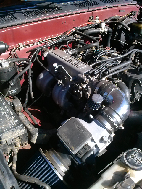

There is a device on the 22re (can remember where it's at right now) that helps adjust the fuel mix at altitude, could be it's not doing it's thing anymore... Stohiciometry is a cruel mistress.

Cold start injector?

I am betting that open element air filter might have a lot to do with this issue.
I have had them freeze and ice up when the temperature is like 35 to 28 Degrees F from the moisture in the Air.
In a snow storm I have seen them freeze completely solid cutting off all the air to the engine.
Learned my lesson real quick on that one!!

Most likely the cold start injector. Not enough fuel to keep it running, at least that is what it sounds like to me.

I doubt it's the cold start injector; that injector is never on once you let go of the key. In addition to starting problems, he can't get the speed he wants up Donner Pass. And the engine is fully warmed up there.
The only device that affects fuel mixture, that I know of, is the O2 sensor. That inherently "adjusts for altitude."
This sounds like a plain ole tune up problem to me. Check the timing, replace the plugs and air cleaner, inspect the vacuum lines. Don't forget to check for stored codes; easy to do.
I don't know much about the climbing ability of the 22re, but my 3VZE hikes me up that hill on a regular basis with no problem. Bone stock.

Wouldn't the main contributor to the problem be the altitude? Agree with the tune up/ 02 sensor if you haven't already done one OP.

Low fuel pressure, fuel filter, fuel pump, fuel pressure regulator or FP VSV stuck.
Vacuum leak somewhere.
Could try jumping FP and B+ on the diag port just before start to give it time to pressure up.

I see at least 2 plugs unplugged in your pics OP, whats up with that? Just wondering if thats related somehow?
