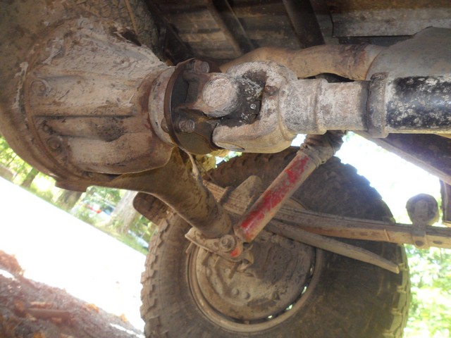

This is how pretty my truck is. That's the joint in question there. In the background those are KYB monomax heavy duty shocks and there's a heavy-load bearing type AAL in there too. 33x10.5x15 TOYO M/T tires at 40-50 psi seems to keep the wear even. Resulting ride, in case you were wondering, is bone jarring until you get about 1500 pounds in the back, then it's real nice. I get compliments when it doesn't squat under a load of wood, and I smile and take Advil for my poor bruised kidneys. On the subject of U-joint failure: I've heard that a gnarly u-joint and the resulting vibration can shake up the pinion gear and seal at the third member. I poked the nose a little and gave it a wiggle when I got the drive shaft off. It seemed pretty okay so I decided not to worry about it.

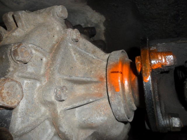

Took dem bolts out with a 14mm wrench (you might want one for the back too) using the double wrench trick and intense Jedi focus. They were tight, but access was good. (Yeah, my garage has a lift in it! har har) At this point the truck is in gear and the e-brake is on. I left one bolt in loosely. Later I would come back and put a second one in loosely so i could roll the truck a bit and bring the front bolts to an accessible position.

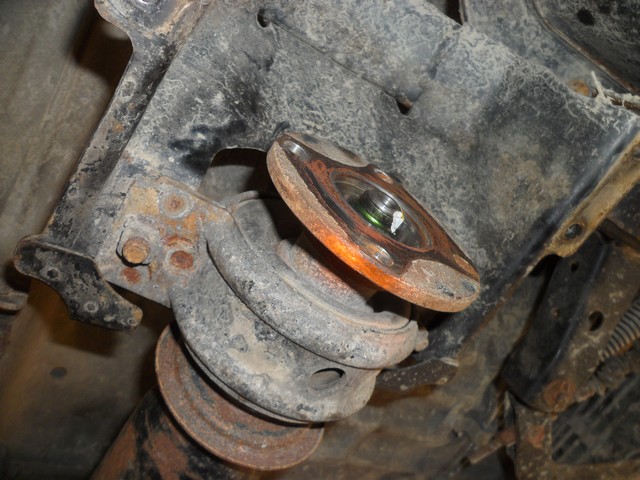

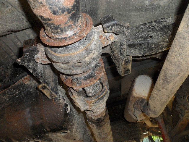

When i took the shield off the middle section there I realized the back half just bolted up to the cardone joint here. So ˟˟˟˟˟˟ yeah that's a big ole' shortcut.

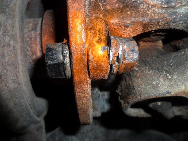

Hit it with a little paint for reference and busted one loose - double wrenching saved the day here those buggers were snug but civilized enough once they knew who the boss was. I ended up rolling the truck a few feet to get to the topmost bolt here - the one's facing the ground are really easy to get to. Just make sure you got a couple bolts in the back too when you roll it and everything stays together.

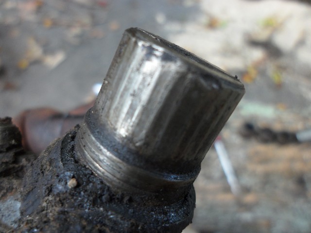

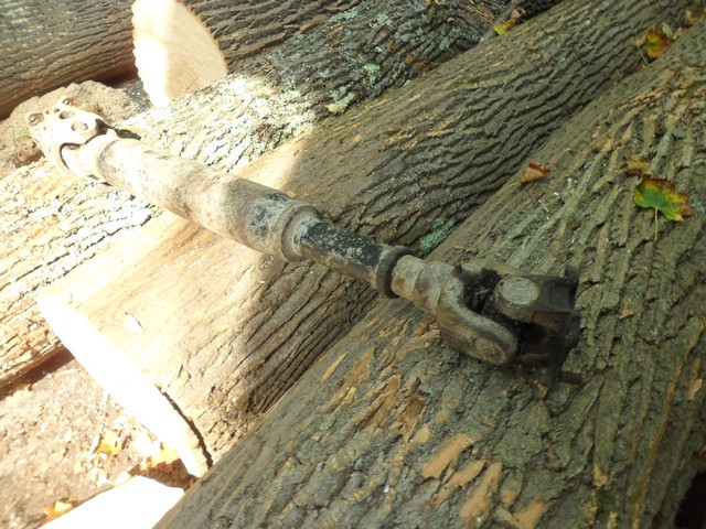

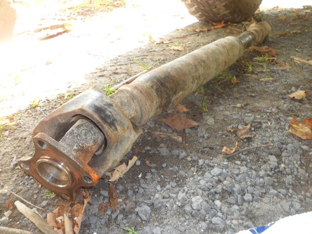

This is what stayed on the truck. I am so stoked NOT to have to pull a splined shaft out of the transfer case. The NWOR guy said all ex-cabs have the two piece drive shaft. Dunno about 'runners.

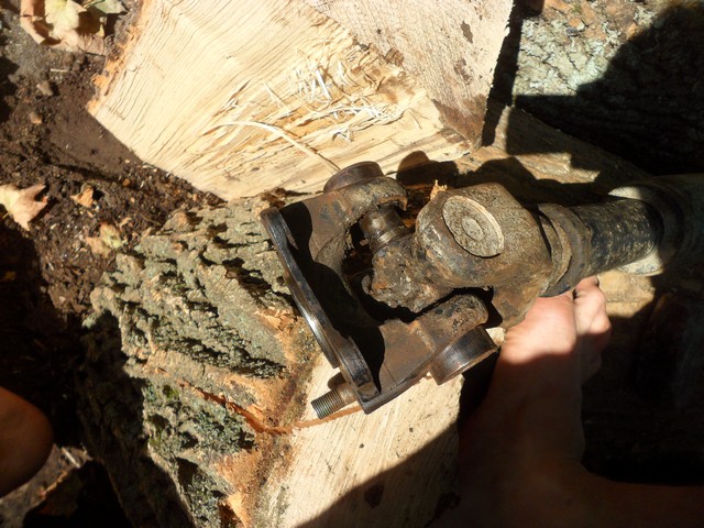

The mini-BFH. My U-joint had clip rings on the inside, so i just tapped 'em out with the screwdriver. The hardest part was finding the ends of the rings 'midst the grime.

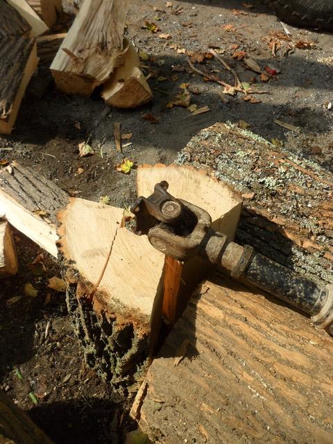

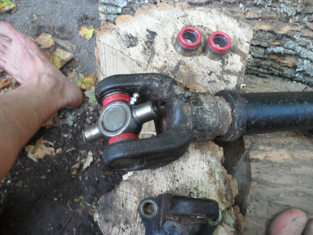

This is how I set it up. Better than a vise, I think, because the wood wont mar up the yolks. Anyway, there's a strategy here to hitting the right part the right way to make it want to pop apart in order. Search youtube. There was a little puzzling, not too bad. Just think it through - the driveshaft part ain't goin anywhere, and the u-joint part is attached to that crosswise, so then the end piece is the part that's gotta move, and you're gonna slide it down off the two caps there. You gotta hit it right where the cap is so it slides off straight, but not on the cap cause the cap's not going anywhere either. So grab a big socket, put it over where the cap is and hit it hard. The biggest socket I had was 27mm, which wasn't quite large enough to get all the way around the cap - so be advised that when they guy in the video says "big socket" he means 29mm or larger. I made this work but it could have gone just a little more smoothly.

I got stuck here for a little bit - you can hammer the yolks down off the caps to this point and then your luck runs out. I found a couple of half inch nuts on the ground and snuck one into the inside of the cap like a spacer so It could push out that last quarter inch or whatever. Man if I didn't have nuts this would have been so much more difficult. Once the first set is done, you do the other pair of caps. Those bad boys get a socket (or a big punch) right on 'em cause you're gonna push them right out of their little holes while the yolk stays put on the two bits of ash there.
