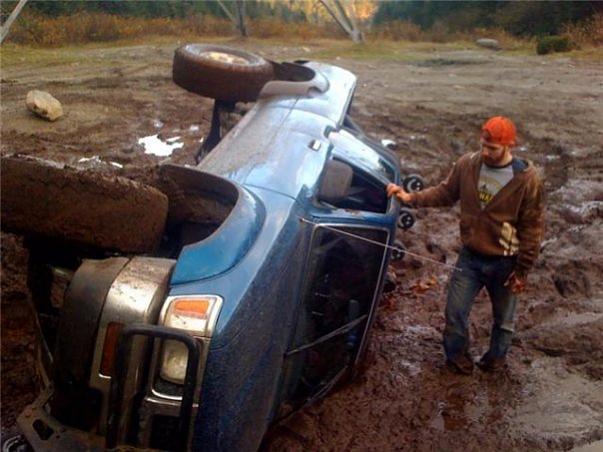

So here's the deal. I put my truck on her side a few months ago (I attached the picture for your amusement) and finally found a good deal on a door to replace the one I caved in; the only catch was that is was automatic. Since I knew how much money I would be saving I decided that the labour to change the door over would be well worth it... that is until I found no such knowledge on the net which is usually my savior.
