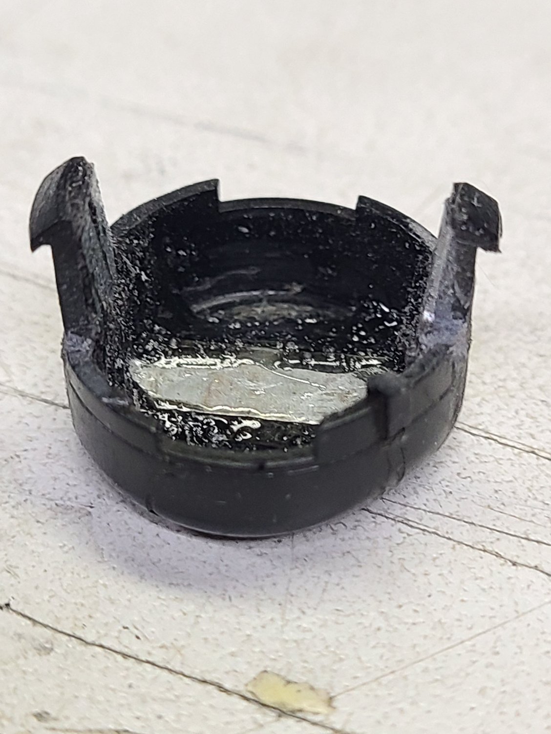

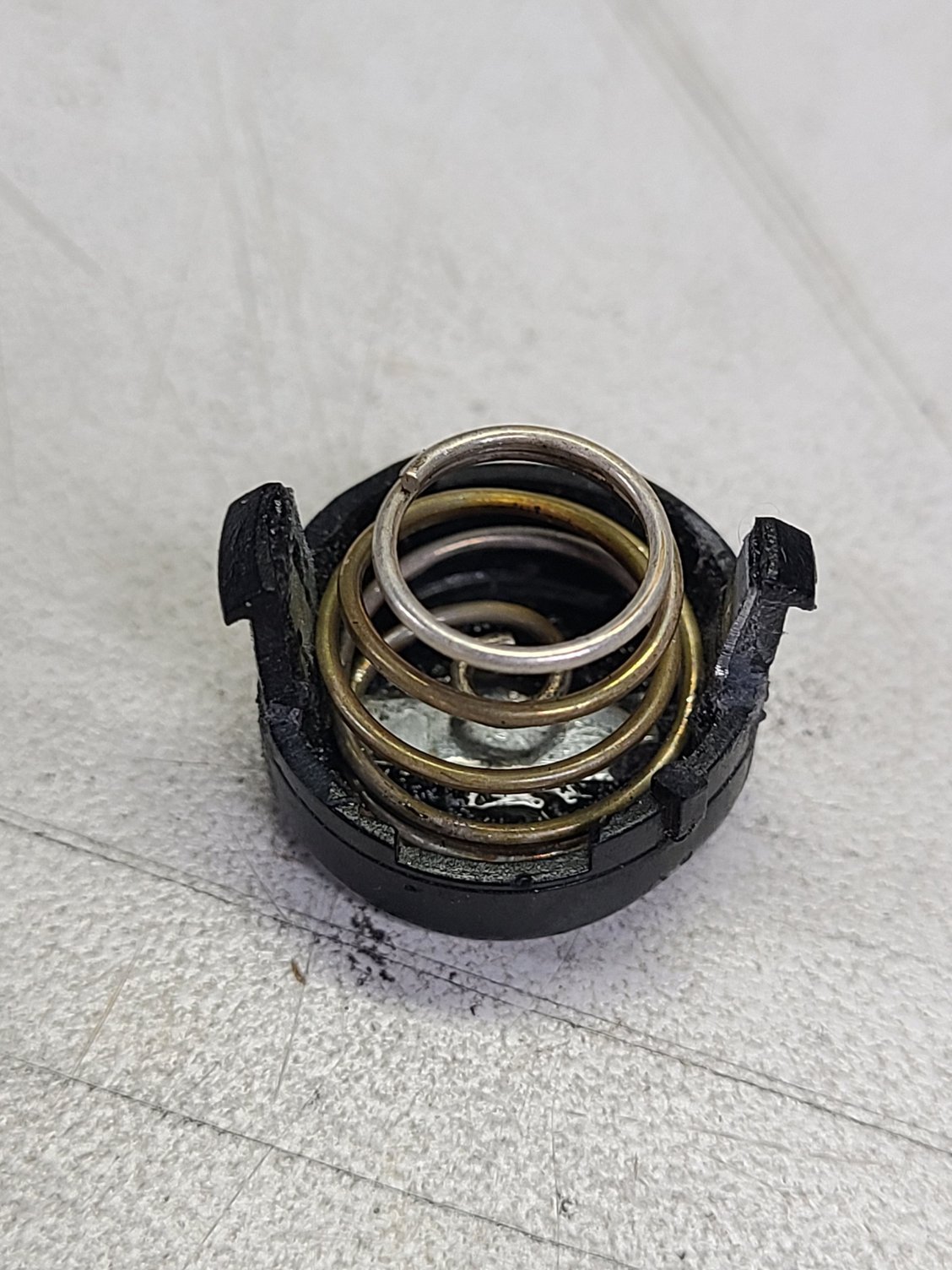

The pushbutton switch on the new-to-me 1987 4Runner was permanently stuck (i.e. always on). So I pried it out, and saw that the push button was jammed in the body of the stalk, and the spring permanently deformed. I was able to re-form the spring, and clean up the debris that caused the jamming. But the push button is falling apart - one leg completely fell off, the other is hanging by a thread.
I'd like to avoid having to buy an entire used switch assembly just for the push button. But it also looks like it's be quite hard to repair the broken one. I could try to 3D print a replacement, but I doubt it'll be strong enough.
Any other ideas for this? I wonder if a button from another vehicle would fit - of course the next question is which vehicle?
Button stuck
Button Removed
Broken Button

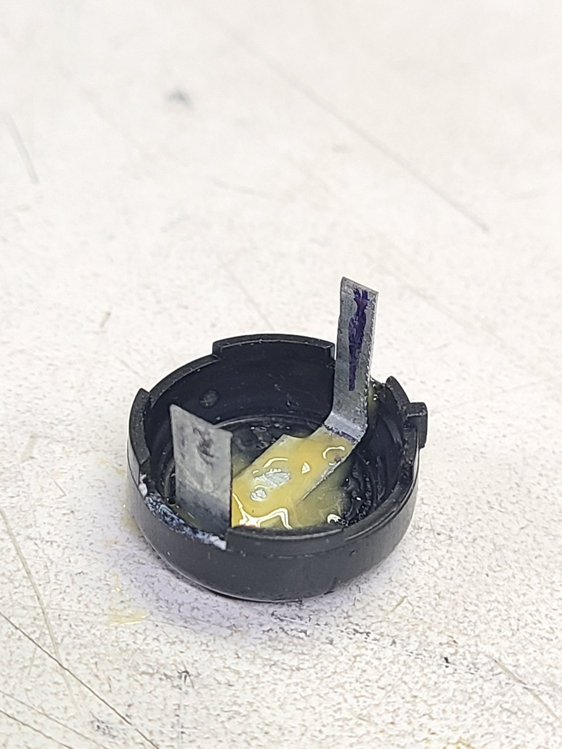

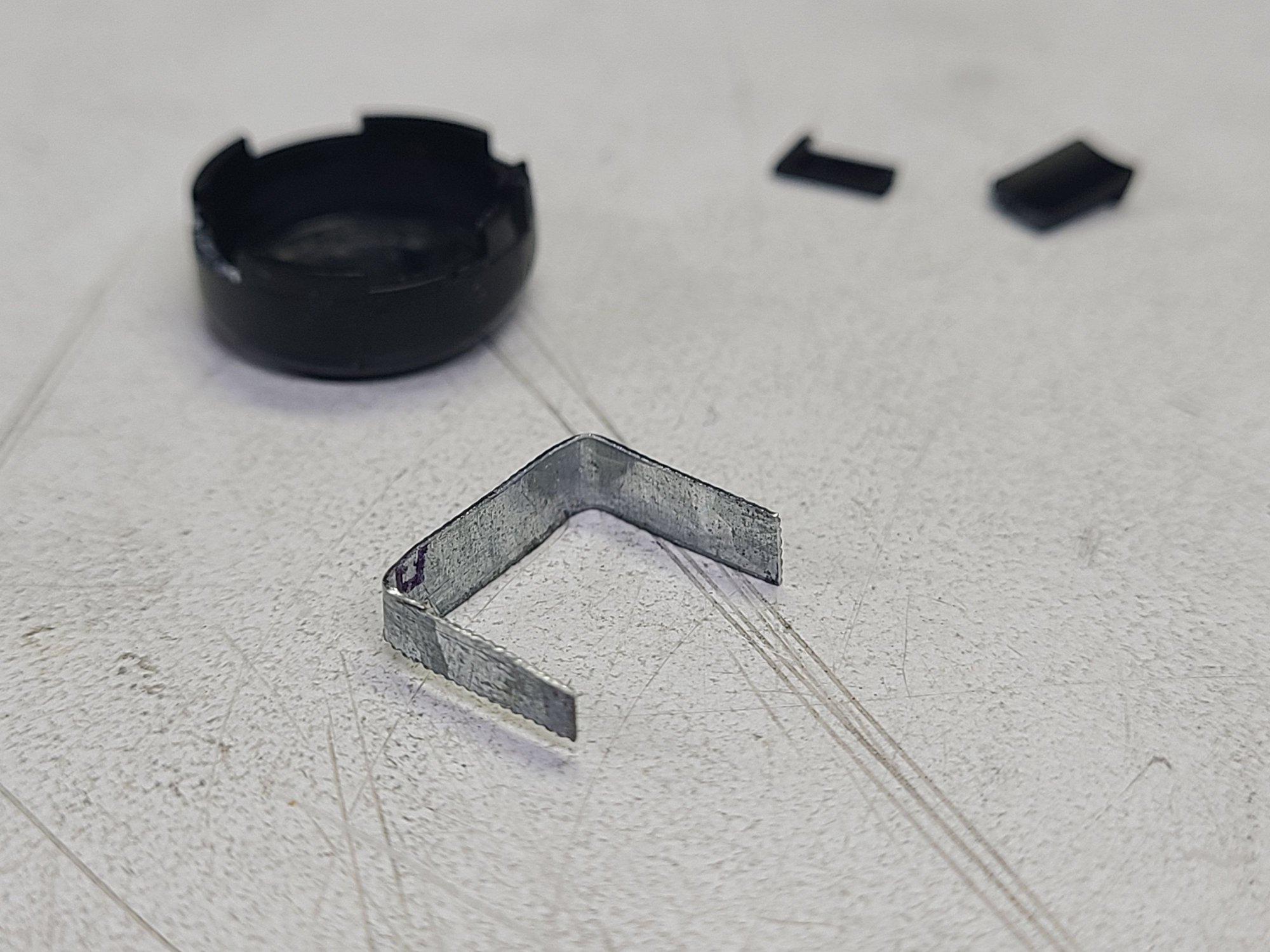

I'm going to start with the easy (though tedious) approach - I'll try to fix mine with some reinforcing sheetmetal behind the broken tabs. Not sure how well the epoxy will hold, but we'll find out.

That's my Plan B, but with the cost of used ones on EBay being close to $200, I figured I'll try the bandaid first. I stepped up to the JBWeld 50139 Plastic Bonder urethane adhesive, supposedly a good choice for metal to plastic bonding. Here are some photos:

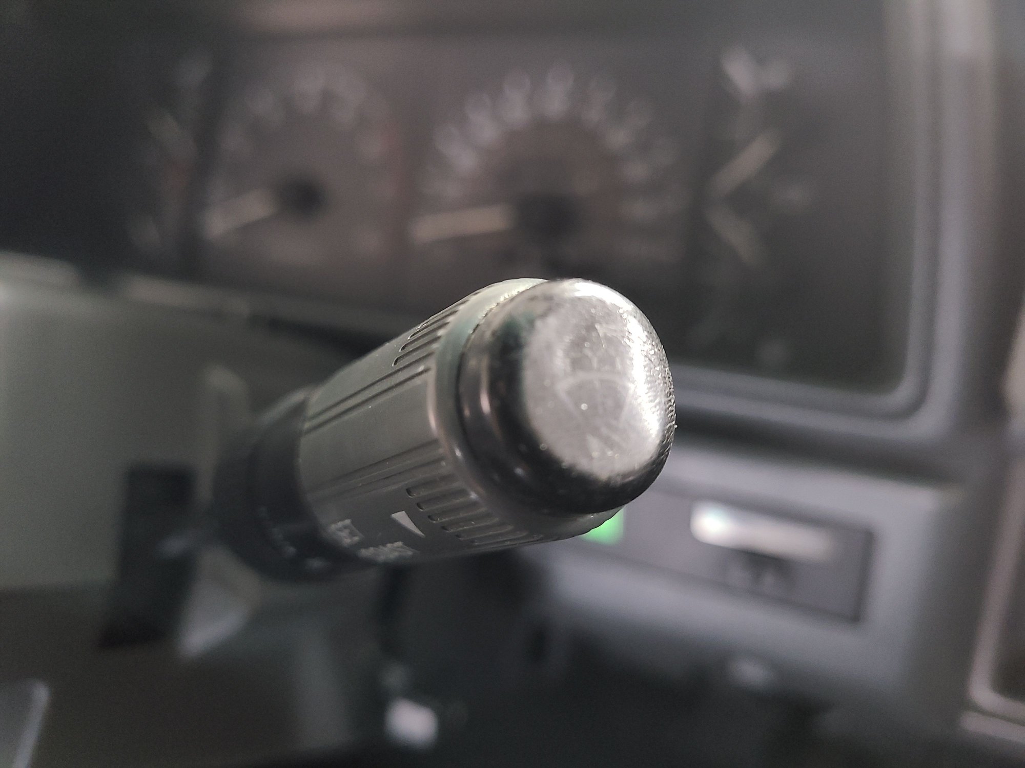

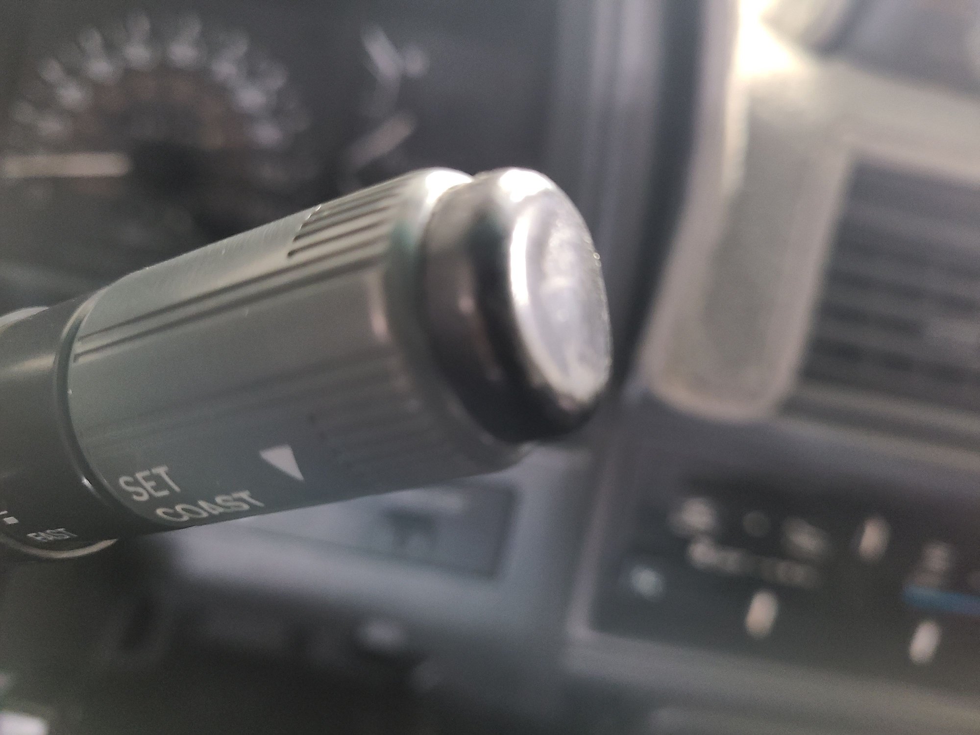

I popped it back into the stalk, it fit nicely and to my pleasant surprise, operated smoothly:
For the ultimate test, I turned the ignition on and pushed the button.. and voila, we have spray again! No idea how long this will last, but I think it's pretty robust for what it is and does.
