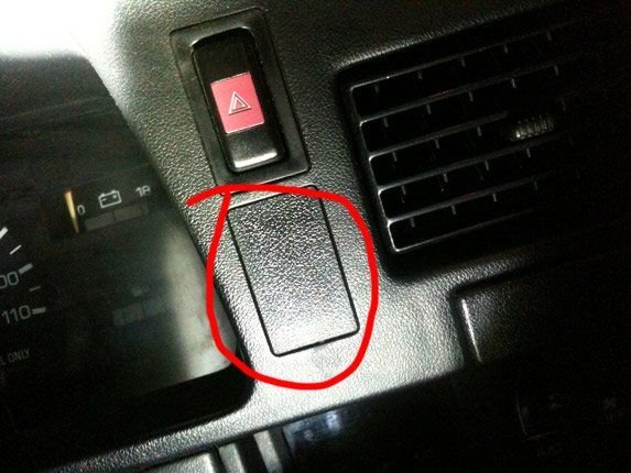

Im looking to replace my Dash blank with a USB switch that will charge my phone or act as a extension to my stereo deck. I order a universal one but it wouldn’t lock into place kept falling out. Does anyone know of a usb style switch the will fit in the hole to replace the dash blank circle in red?

The ones that say "fits Toyota" on eBay, don't fit ours. I think new(er) Toyotas have smaller switch blanks. If you search "Toyota Switch Blank" on eBay, you might find something that fits (there were 3k hits but some might actually have been the older size). For mine, I just used an existing switch blank and really carefully dremeled and filed it out little by little to fit. I thought I had taken pictures of the process, but not finding them. I remember using blue painters tape to mark on and get the initial layout on.

I did the same with a “ebay fits a toyota” I dremel out a blank to make it work but it just looks ugly and falls out whenever I unplug a cord.

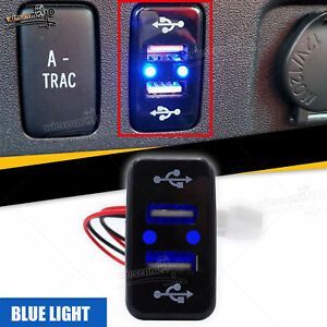

Carling does make their own dual usb port. https://www.carlingtech.com/controls-v-charger This eBay seller claims theirs is Contura "style." https://www.ebay.com/itm/Dual-USB-Ch...-/172533349205
But what about the one I cited earlier?
Amazon Amazon
They give measurements, and claim the required mounting hole is 37.2mmx21.2mm - just the tiniest fraction too large! They give the outside measurements, and at 45mm it's just too long. But if you look closely at the photo with the measurements, that can't be right. You can measure it right on your screen, and the measurements aren't in proportion.
Last, all this "analysis" depends on my guess that a Contura style switch would fit. I'm guessing that yours fit well into the mounting hole, but the problem is the spring-fingers don't grip well enough. Which means all of this may be for naught.
Nonetheless, I'm tempted to drop $14 (+tax/shipping) just to find out.
