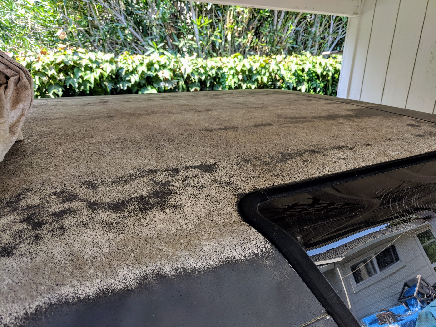

I was finally able to get some more time on the new 4Runner over the long weekend. Here are a few pictures of the top. Curious what you all think of the condition:
The texture if very rough!

Much better, well images anyway. That's pretty typical for exposure damage after all these years
You can seal it with a polyester or 2k doesn't matter which type, brand(topcoat, gelcoat, awlgrip), or application (spray, brush, roll) method (to me, it's not my profession or something I do on a regular basis).
I would go with 2k (epoxy), pretty sure thats what it was originaly done with. You do not want to use a filler (Bondo, everkote ect), these are poly/2k with inert solids. What is important is you get it dry(fiberglass wicks moisture), sealed (glass covered to several mils), then preped for the topcoat of your choice. Keep in mind that's a lot of flat surface and a gloss coat will show any waves, it's why you mostly see them with hammered or other textured finish (the man hours of sanding).
And yes that's definitely exposed glass avoid touching it, unless your into that sort of thing.

Thanks for the reply. And no, touching exposed glass is not my kinda thing! I am pretty paranoid about fumes/inhalents and honestly the whole idea of refinishing it is making me uneasy about the process.

The gel coat is the outer layer of a fiberglass structure. Co 94 was not implying the entire thing was made from gel coat. In a female mold, the gel coat is the first layer applied.
You don't want to use epoxy resin if there will be a gelcoat applied either. You can get gelcoat additives for the epoxy, but it'll be pretty expensive compared to just applying a gelcoat. Epoxy resin doesn't sand very well. It's too tough. There are additives to make it more sandable, but it'll have to be painted and that's more steps. Just doing a colored gelcoat would be the easiest and cheapest.
