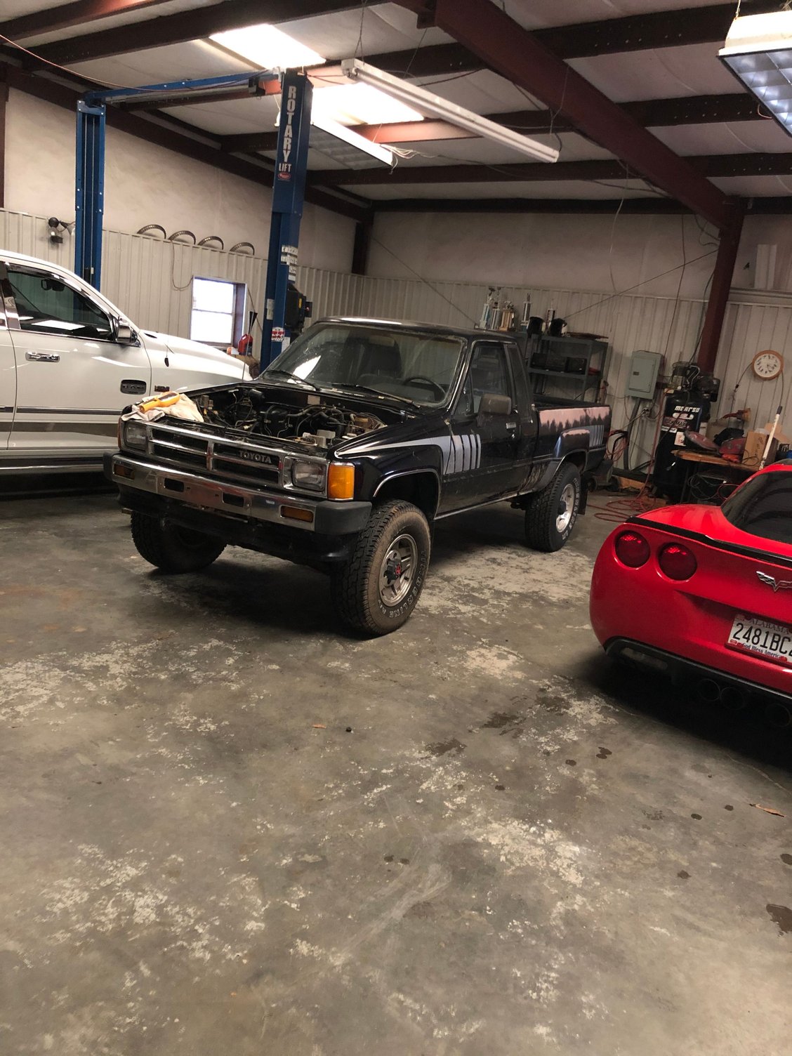

Thanks everyone. I was able to get it out without removing the trans. It was actually pretty simple. Now I just hope I can get everything to line up and go back in as easy once I finish rebuilding

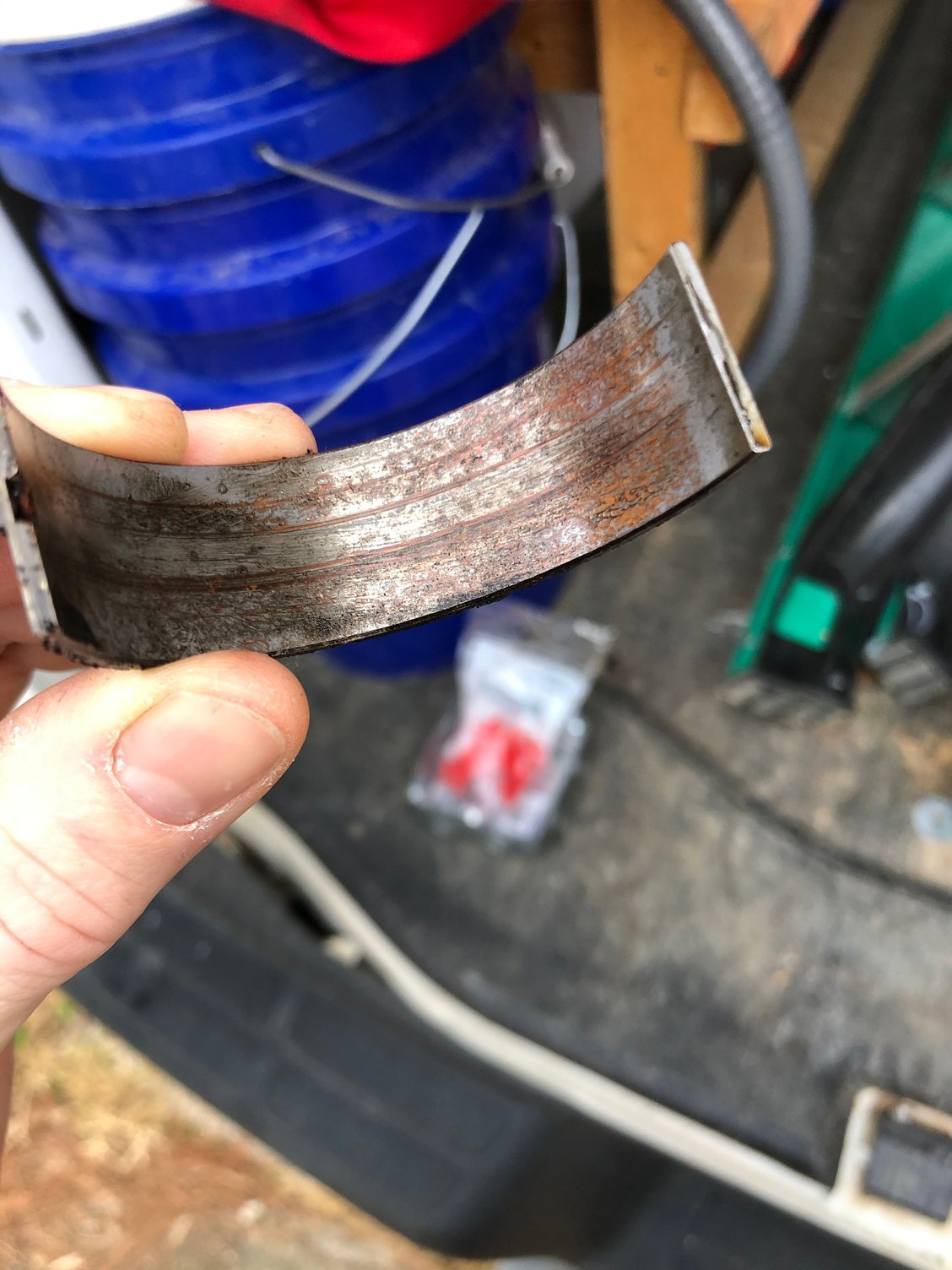

This was one of the better rod bearings. And I was just hoping to replace the timing chain but the motor had other plans
