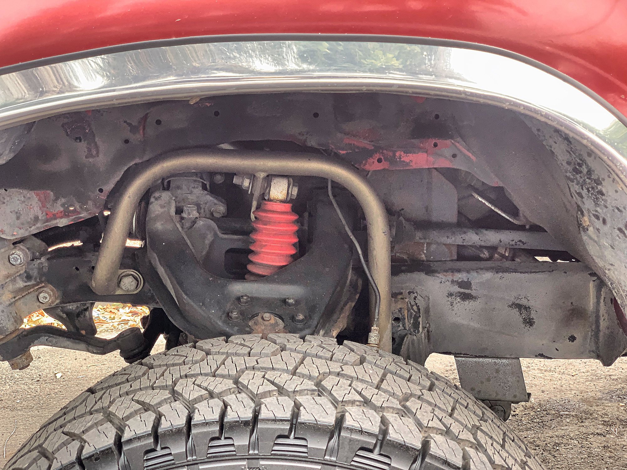

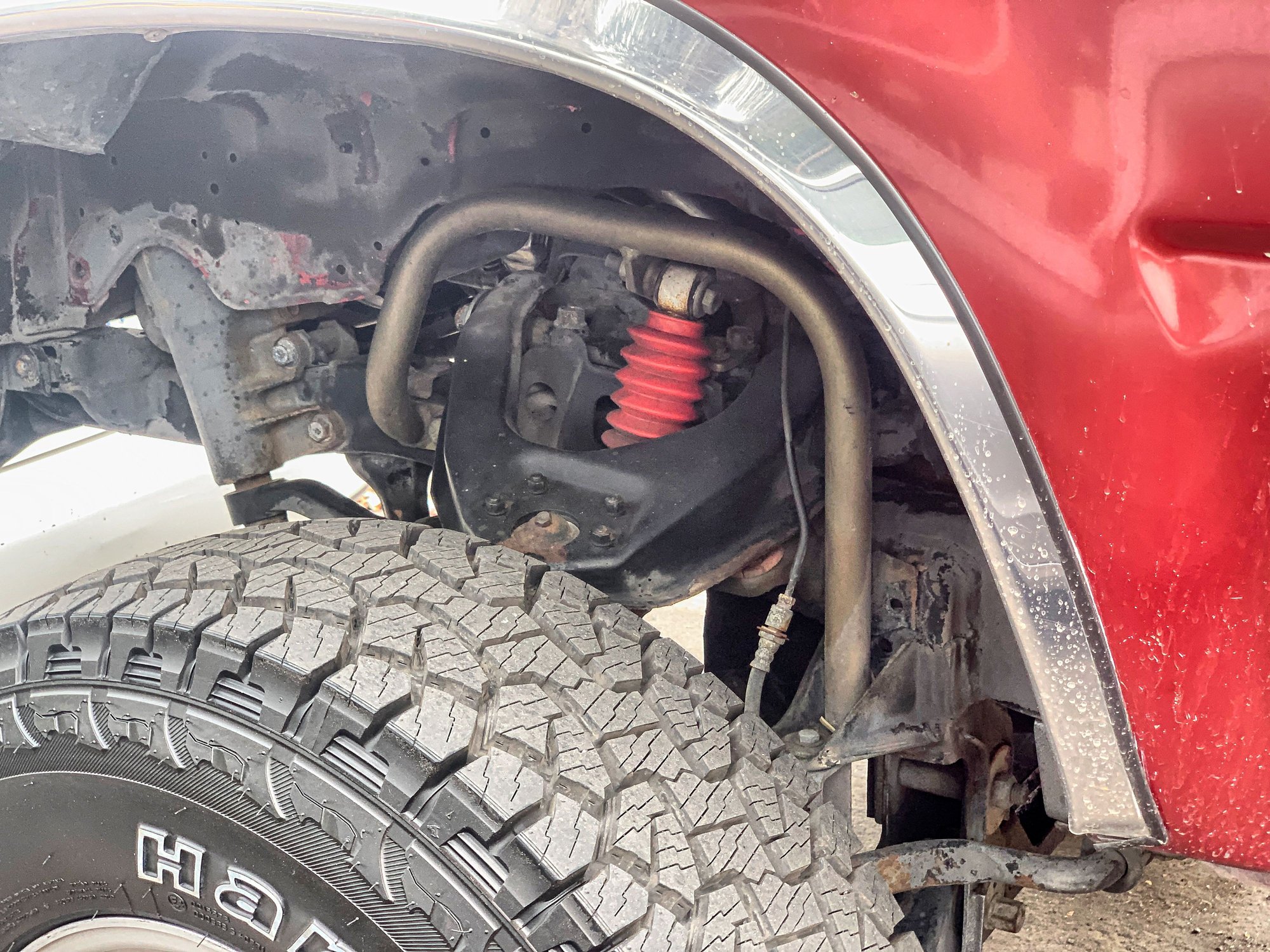

...and - do they actually have an advantage? I’m still a little confused about how exactly the T- bars, Shocks, and extended travel kit, And CV angle limits and CV angle limits all work together to get the most out of IFS travel and articulation.
Currently I have the Blazeland extended travel kit in my front end (Which has been amazing on the trails for the past six years I’ve had it on there - thanks Nate!) A 3im bracket w/BJ spacers. The current shocks attach at the stock mounts. In complete honesty, I just think hoop shock mounts with a little bit of a shock peeking through above tire looks badass. But I’m not gonna drop any money on them if they really don’t serve a purpose. However with the extended travel kit, I am wondering If having a longer shock in there would be advantageous in someway.
i’ve looked for them before online but never came across anything specifically for these trucks. However I was driving through some neighborhood their day and saw a early 90’s toy with these installed. Any ideas where they’re from?
Please advise, much oblige.

Im no expert but since no one else replied...
idk what brand they are.
the benefit is a longer shock, which gives you more dampening and a smoother ride. You can install eye to eye shocks instead of stem to eye, more options in eye to eye maybe? A lot of higher quality aftermarket shocks are longer than stock ifs shocks so it opens the door to more possibilities.
Is the stock shock mount gone? I dont see any problem with them. Usually theres a couple braces on the hoops, which youd want if youre gonna wheel it. For street driving theyre probly fine as is if they feel secure.

Those shock hoops actually look a little weird to me after a closer look. The bolt on top isnt perpendicular to the shock. The rear mount seems kind of weird but i cant tell from your pics.
You can find good aftermarket shock hoops at any 4x4 parts store
https://www.lowrangeoffroad.com/cata.../?q=Shock+hoop
And plenty of youtube videos on how to install. You will need to weld.

Those look like Downey shock hoops, company is now out of business.
https://www.yotatech.com/forums/f109...-hoops-289019/

Hey all, thanks for the opinions and responses.. Understood more about shock hoops and the Low Range OR site is great resource for them...will just need to find someone to fab them up if I end up going that route.
