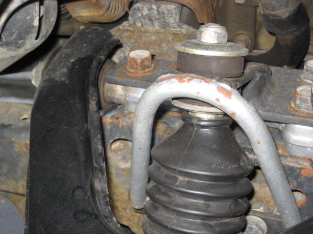

Before you go cutting up your ride and welding on Ford shock towers, or other devices, you might consider a few things. First, a little history of what Downey and NWOR was having people do to get longer shocks was to install shock hoops. Back in the day it wasn't just better to go longer but also to double up. Granted the shocks were valved to be doubled up, the advantage was the loads were divided and there was twice as much cooling capacity. The idea is to reduce shock fade. Today this is accomplished with reservoir shocks.
To install the Double Shock Hoops one needed to cut off the upper shock tabs. The hoops would allow a shock with about an 8" travel. There were some complications to the double shock as the second lower mounting bracket needed to be welded onto the LCA. The front shock would hit the steering arm reducing the turning radius. The shocks used a 5/8" bolt to fit into the metric tabs but it was a loose fit. The 5/8" bolt meant the bushings steel inner sleeves for 1/2" bolt came out. Without the inner sleeve the assembly couldn't be tightened down or you would be bending the shock tabs in on themselves. This design also meant buying the shock hoops plus (4) shocks. Add it up and it started to get expensive. Other than that is was a nice design and worked well enough.

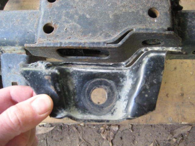

Another approach to get longer shocks was to cut off the upper shock tab and install a shock tower. ProComp offered this shock tower and it could be used for single or double shock. The tower bolted on top of the UCA cross shaft with the three factory bolts. There were problems with this design as well. The lower mounting bolt and tabs from the factory are metric and the shocks to be used didn't match up all that well. The other problem was by mounting the tower on top of the cross shaft it transferred the shock loads off the frame and onto the cross shaft assembly. This was a horrible idea because it would rip the cross shaft bolts right off the frame.
It happened to me in 2003 while pre-running the Baja 250. I had made a shock tower that mounted on top of the cross shaft that allowed me to run a Bilstein 5100 direct bolt in shock for a 4" lifted truck into a non-lifted rig. This configuration allowed a longer shock that was valved for this vehicle but it overloaded the cross shaft. Later I added some out rigger supports that added strength. Then when I went with long travel I needed to lower the tower height. The lower mount moved out increasing the shock angle to the point where the UCA hit the shock with the tall tower design.
