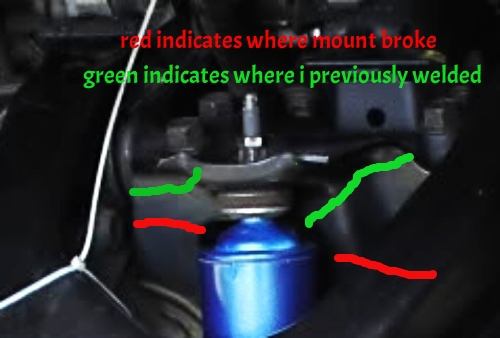

found an old picture.... trying to show the best i can what happened. Name:  fc499663-4cd7-490a-ac78-f38ebfd942f1_zpse8bb7d70.jpg

Only other thing I can think of is reweld, then add vertical gussets. ooooooooooooooooooooor, SAS and be done.

Also, if the steel failed as you indicated in your graphic I'd suspect damage to the cross shaft mounting plate / bracket. It may also have pulled that up and off the frame.
Another condition you may investigate as a factor is the factory rubber bushing in the UCA are not full floating and will allow bind in the bushings. The rubber bushing don't rotate on the shell and sleeves they are a solid bond and the rubber twist on itself. Under extreme articulation caused by modified bump or droop stops, BJ Spacers, or LT the rubber chunks apart and destroys itself. When this is going on it puts a lot of stress on the cross shaft which in turn can rip the threaded bungs through the cross shaft plate or tear up the frame brackets. Free floating, Non-Binding Poly Bushing are a good upgrade to let the UCA flex.
