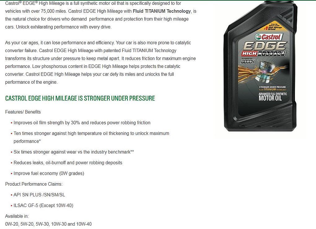

Not that I'm aware off. It SAYS it's a full synthetic on the bottles. Honest, it does!
I'll see if I can get a picture of the bottle. Worst case, just take a look next time you're in the auto parts store that carries it.
From the Castrol site...
This is what I use in both trucks I have.
Does this help at all?
Pat☺

I believe you. I think it has a different chemical makeup than classic full synthetic, or something along those lines... I haven't seen anything but Schaeffer's for the last 10 years so I'm a little rusty. Maybe SynTec is much better!
