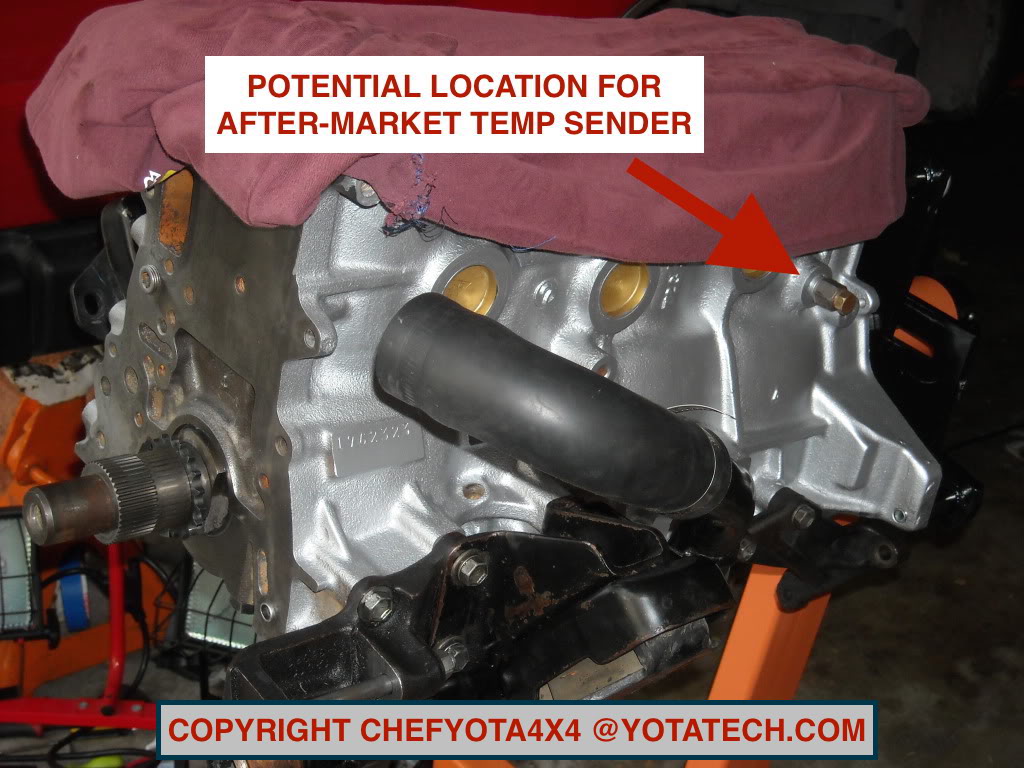

I don't trust the stock gauge. Doesn't give actual temp reading. I'm also working on finding aftermarket. I want:
1) Electrical with a sender.
2) To Mount sender directly on the engine block so it will always read liquid even when coolant goes low. (When my HG finally blew, I was reading lower than normal on the freeway; probably because temp sender ontop of thermostat was not touching the liquid coolant anymore).
3) To read actual temp in degrees F.
4) Option, if I can find it, is one with contacts that close at certain temp to trigger a buzzer and a light to catch the attention.
Potential location of aftermarket tmep sender, courtesy of Chefyota:

I installed an Equus 8242 mechanical water temp gauge today. I put it in the gauge sender location. I put the gauge sender where the FPU switch was for a "back up". I also got a 9852 adapter from Equus to put in the sender location. I am pleased with the gauge and adapter. $33 for the gauge and $6.49 for the adapter. I'll put some pictures in the post I started titled Aftermarket temp. gauge.
