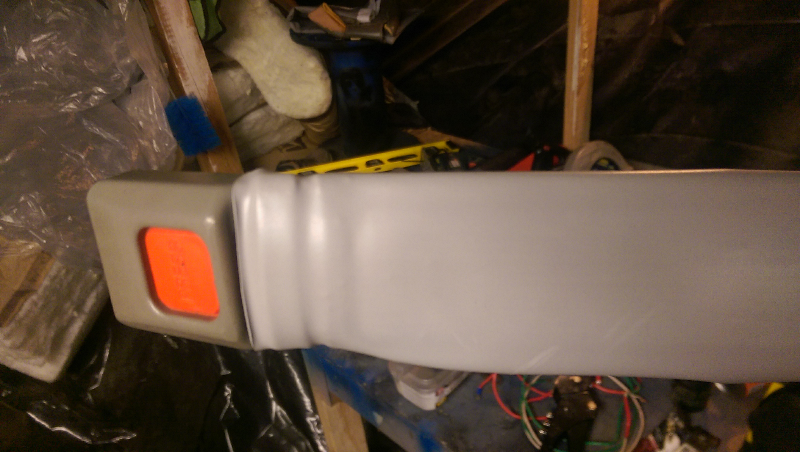

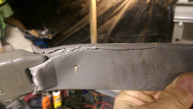

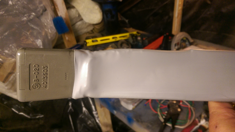

In my everlasting attempt at restoring my interior, the cracked seat belt receivers and my OCD got the best of me. I've not had much luck finding, at least the drivers side, receiver that isn't all busted up at the top. I tried fabric glue which as expected didn't hold for long. Then I used zip ties which looked like zip ties. Then it came to me. Shrink tube. I figured out that 1 1/2" tubing would fit snuggly over the receiver. I ordered 4' of grey tubing so I could mess up once or twice. Little heat gun action and a nice easy fix.
This is what I started with.

And that's what I ended up with.

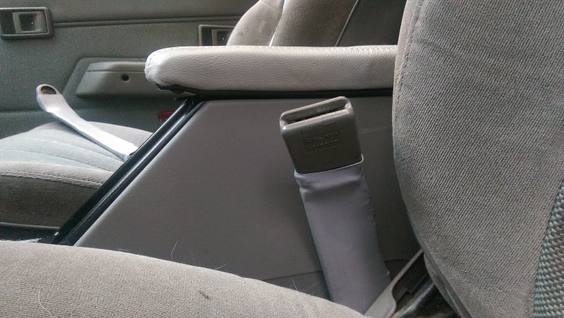

hah! Did the heat-shrink approach on mine, a year ago. Works well
However, I still need to rig the passenger side so seat it does not snag/drag it when sliding back.
That is annoying isn't it. Short of pinning it to the console I can't think of anything.

yep. Already have an idea. Will tie with a shockcord around the actual girth of the console, underneath the facade. Just been to busy to take care of it. Will post pics when done.
