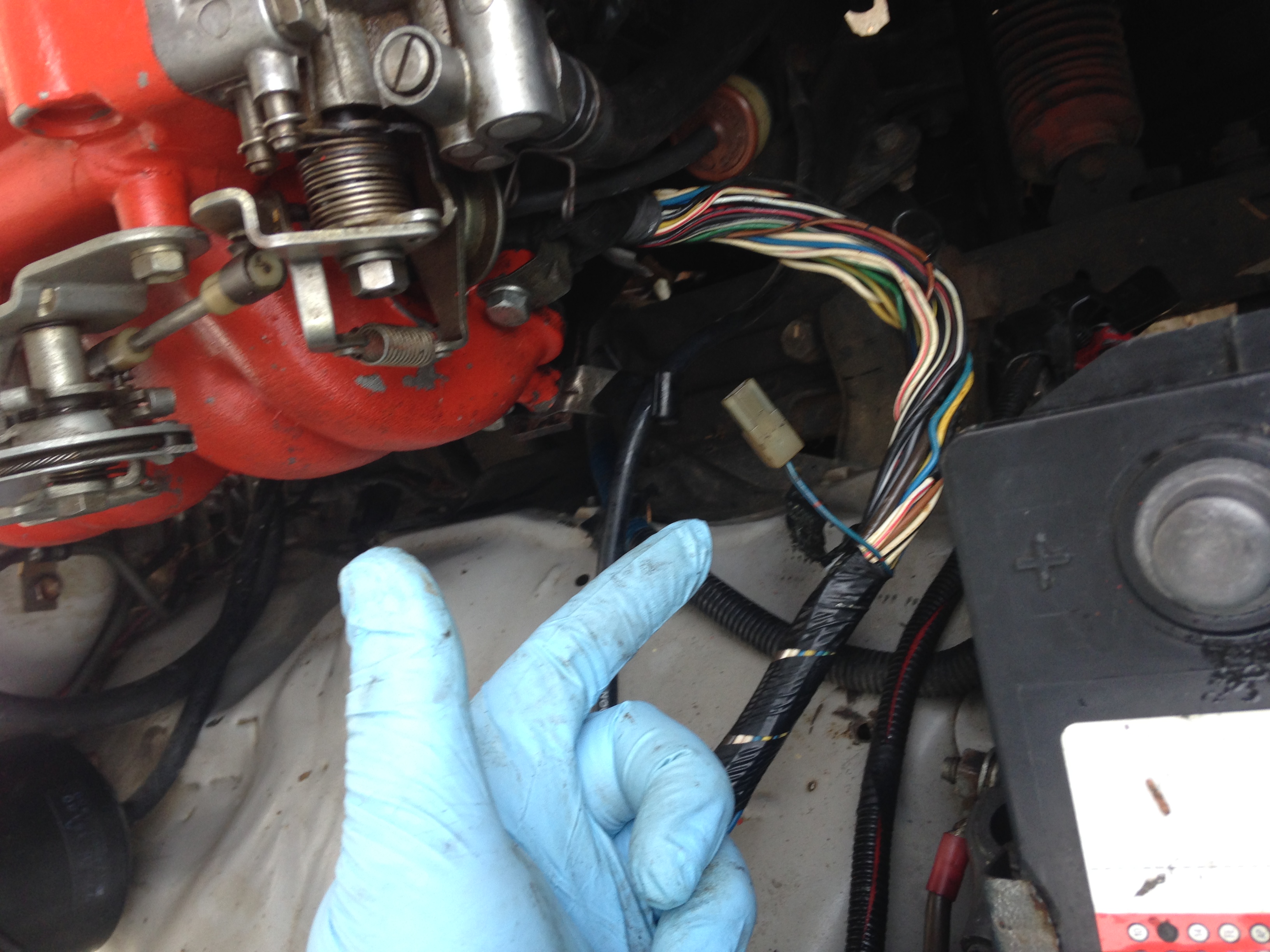

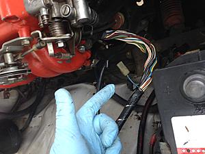

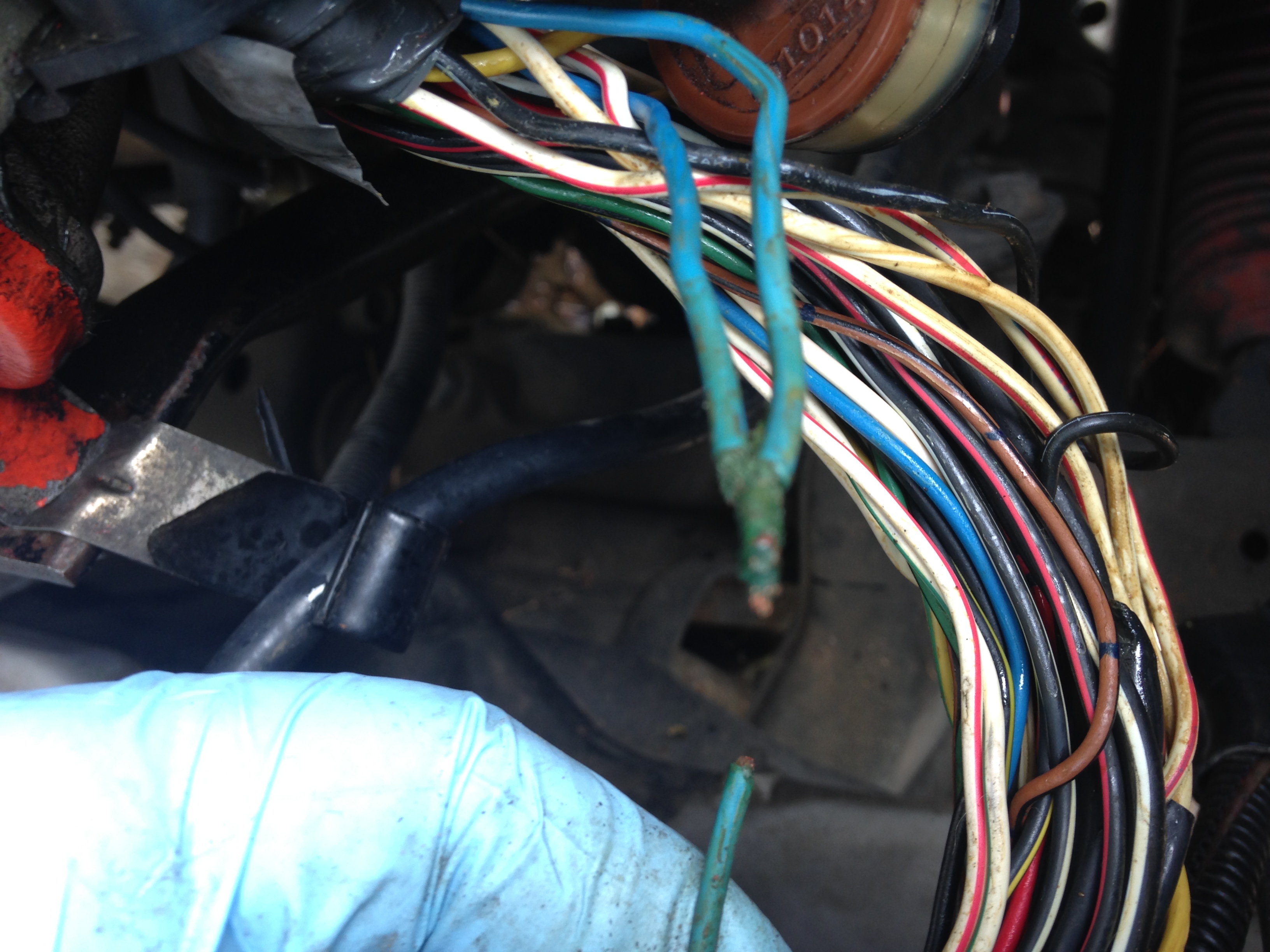

I had a similar problem with misfires on my 86' 22re so I sent off the injectors to WitchHunter Performance to get serviced and while they were there I opened up the wiring harness and found multiple injector wires were barley connected. That was my problem, so I cleaned the wires, soldered them, and used heat shrink. Runs so smooth now with calibrated injectors and solid wire connections.
Attached Thumbnails Rebuilt 22re has a bad miss-img_3736.jpg   Rebuilt 22re has a bad miss-img_3739.jpg
