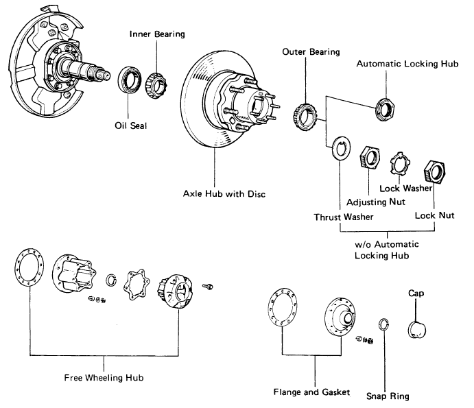

- What hardware am I missing that's not included in the rebuild kits? Snap rings, a pair of massive nuts (lol), and some other knick knacks? I've never been around these axles before, but I have watched a few rebuild videos. For those familiar with these axles, please let me know what I need to put this thing back together. If you have spares of any of these items laying around, I have no problem paying for them.

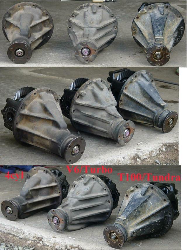

The front axle Can use the same 3rd members as the rear from '79 to 1985. Here are some info sources::
Erik's Toyota Differential info (4x4wire.com)
Toyota 4Runner Technical Information (4crawler.com)
After 1985 fronts are IFS, but rear diffs up to at least 1995 will fit the earlier straight front axles.

Based on the first link you sent, the 4cyl 8” diff from the 89-95 should drop into my 1985 solid axle without a problem. No idea on the ratios. I believe they’re all stock diffs. Very good.
Now as for the hardware (nuts/bolts/flanges/pins) I’m missing that’s NOT included in a rebuild kit... any ideas?

You can get most of your missing parts through trail gear, low range, or yotashop. Or a dealer. Look through what you have, and what it takes to rebuild the axle, and you should be able to find what youre missing.
