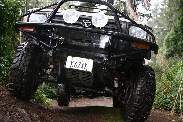

First one IFS (what you have), second one SFA.
For some reason I haven't been able to get on Photobucket, so They are attachments..sorry
Oh and thanks Toyospearo for these pictures from the "Why does everyone trash IFS?" thread.
Attached Thumbnails Solid Front Axle Questions-img_2733.jpg   Solid Front Axle Questions-img_1557.jpg
