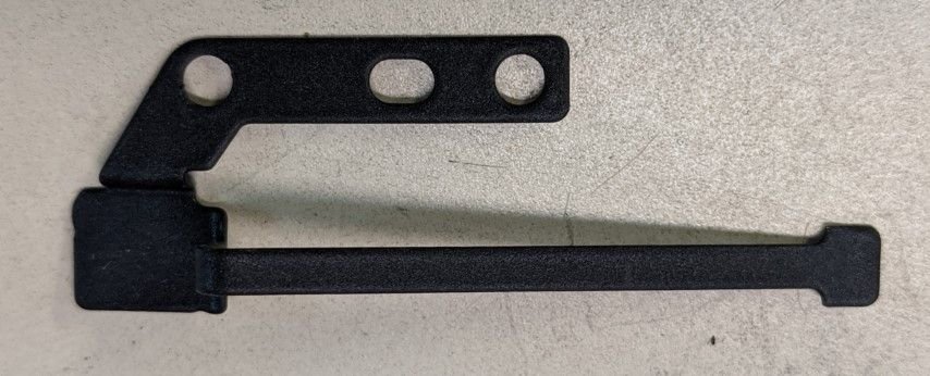

I purchased and installed a new rear blade, #85220-22461. It's very similar to the original blade, but adds a spring under the mount to return the blade to flat when unloaded. If you keep this spring, you'll need longer screws, such as M3.5 x 8 as it makes the mount plate thicker. Or you can easily remove the spring and use the original screws. Photo of spring attached.

The return (zeroing) spring:
