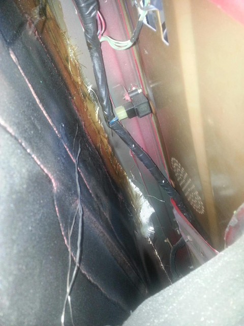

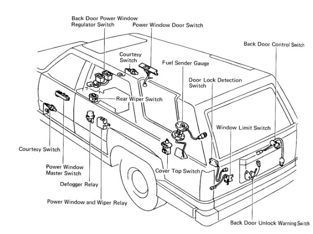

Finally figured it out. The "cover top switch" requires the bolt for the top to be inserted for the truck to know that the top is on and ok for the window to go up. U can see an actual picture of it in the color picture. It's the box looking piece at the top that runs directly under the second to last bolt on the driver side.
