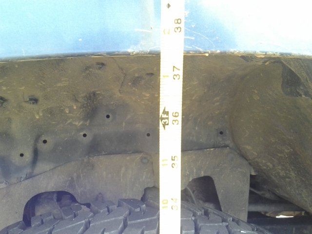

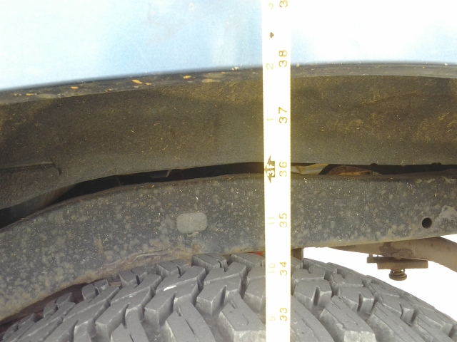

Just did it a couple weekends ago. Worked well, looks good. I will say pay close attention when you're seating them, make sure they're seated well and in the right position. Yes, the coil seats have a larger diameter, the spring sits more on top of it instead of completely around. I've flexed it to the max on trails in my neighborhood testing for movement/issues and so far so good. Hoping to get in a real trail run soon but still gonna play close to home until I'm 100% confident. Wabbit, sorry about the emails on my brake line, I was anxious to git 'er done! NorCalBorn, thanks for the advice! He's been talkin about this spring swap for a few years now but no one's been listening.

Despite my shaky tape measuring skills, I'm sitting at about 37.5" all the way around(slightly lower on the passenger side of course). Solid 2" lift in the rear, no need for BJ spacers to level and I can run 33's with minimal work up front. $60 for springs(rockauto), $60 for shocks(scratch n dent special), $60 for panhard bracket, $20 for lspv bracket. Very happy with the set up.

So those came off the rear of an FJ Cruiser? Leveled the truck out nicely, looks good! I didn't think they would fit after searching but yours look like they fit pretty well.
