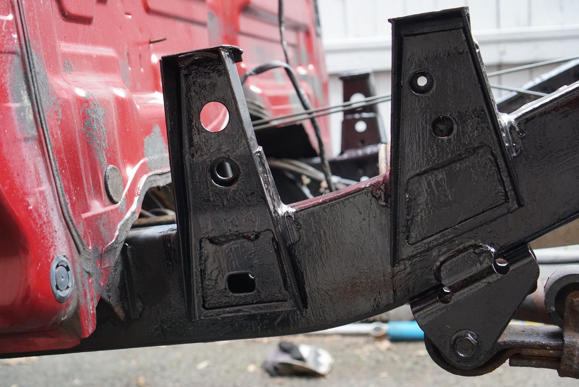

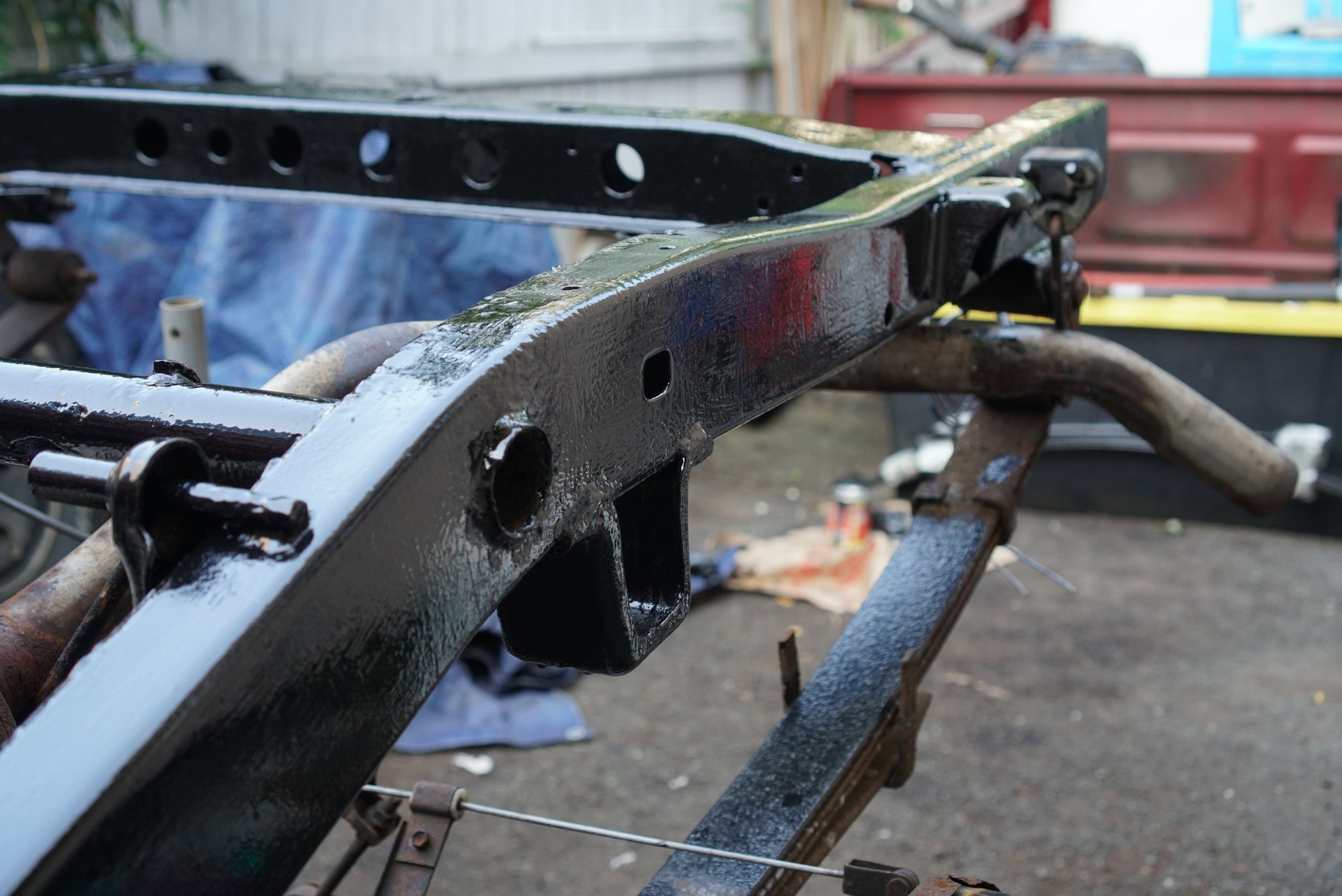

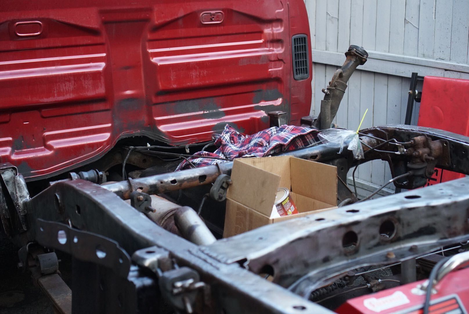

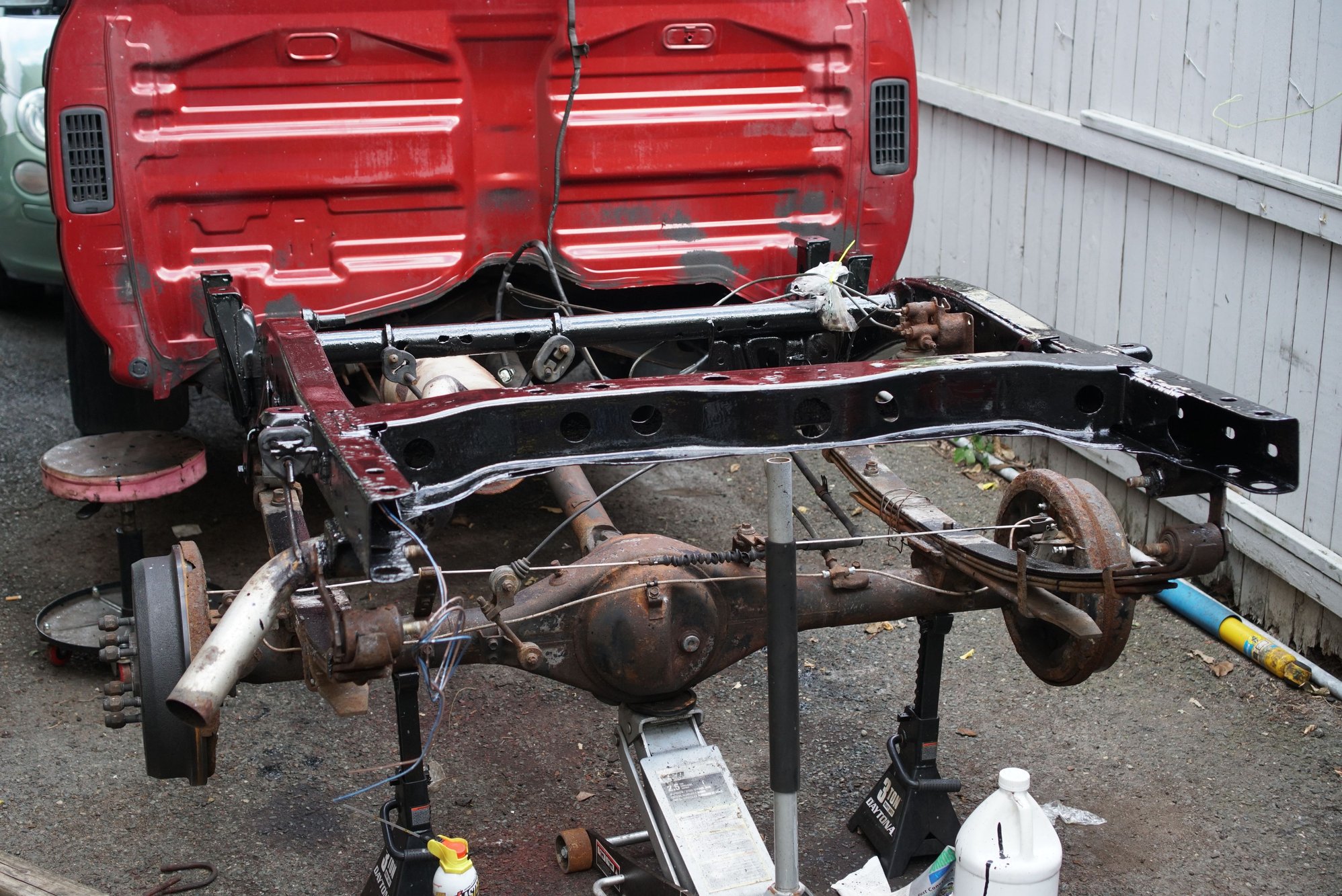

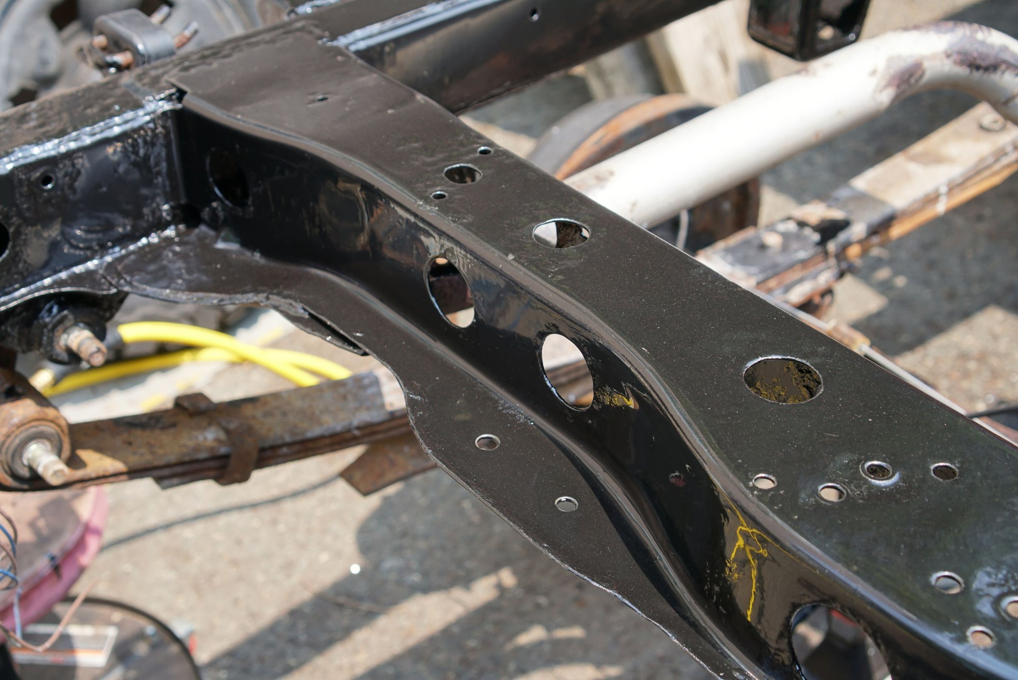

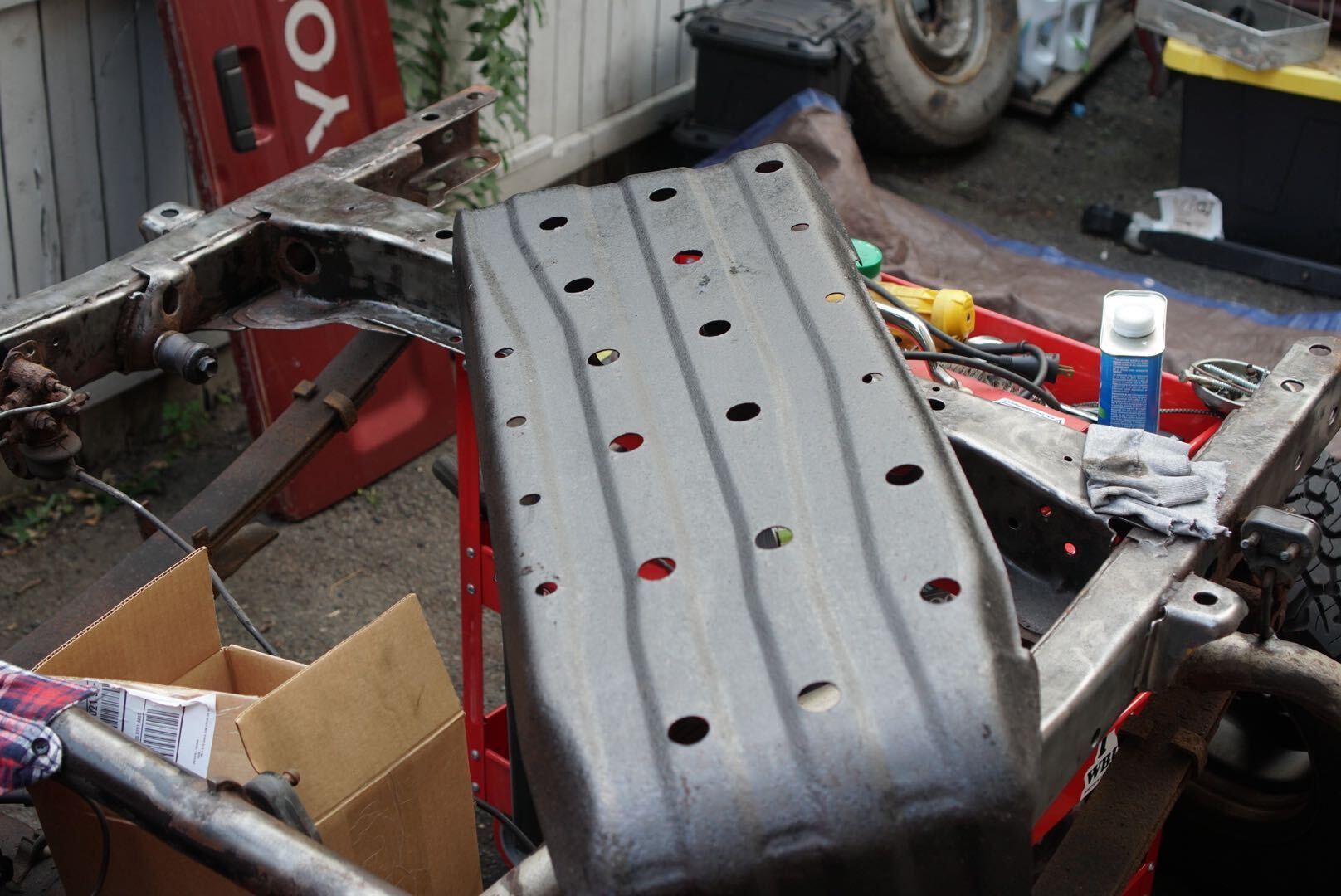

I'm in the middle of the biggest project I've done on my truck so far. After owning my '91 4WD for just about two years in the Northeast, I wanted to make sure the frame was in good shape to resist the snow and ice and salt moving forward. I have a new set of leaf packs from LCE to swap in while I'm at it since each side of the originals has a broken leaf. I've got most of the frame down to the metal with any rust addressed with either a wire wheel or needle scaler and am going to be painting it with POR15 this weekend and then following up with a rubber undercoating spray + a coating of fluid film before it snows for the year. I'm also using Corroseal on things like the gas tank shield (followed up with bedliner) that so far I'm loving.
My current question is the rear shackles. I'm having trouble finding replacements for the originals that I don't want to reuse and the nuts for are toast. I see there are a couple of options like Dorman 722-043 that are listed as the RWD replacements but haven't found any for 4WD models. Alternatively, everything on LCE has some sort of lift which isn't the goal at the moment. Can somebody point me in the direction of a stock replacement? I would love to have a greaseable set.
Here's where I'm at right now, as well as a "before" pic for posterity:

NO NO No!!! Rubber undercoating is the worst thing you can use . Unless your prep work and application is 100% perfect you get moisture trapped in any air pockets from condensation and it just keeps rusting
Do The POR 15 and apply Fluid Film every fall
Where in the North East the liquid Brine Belt

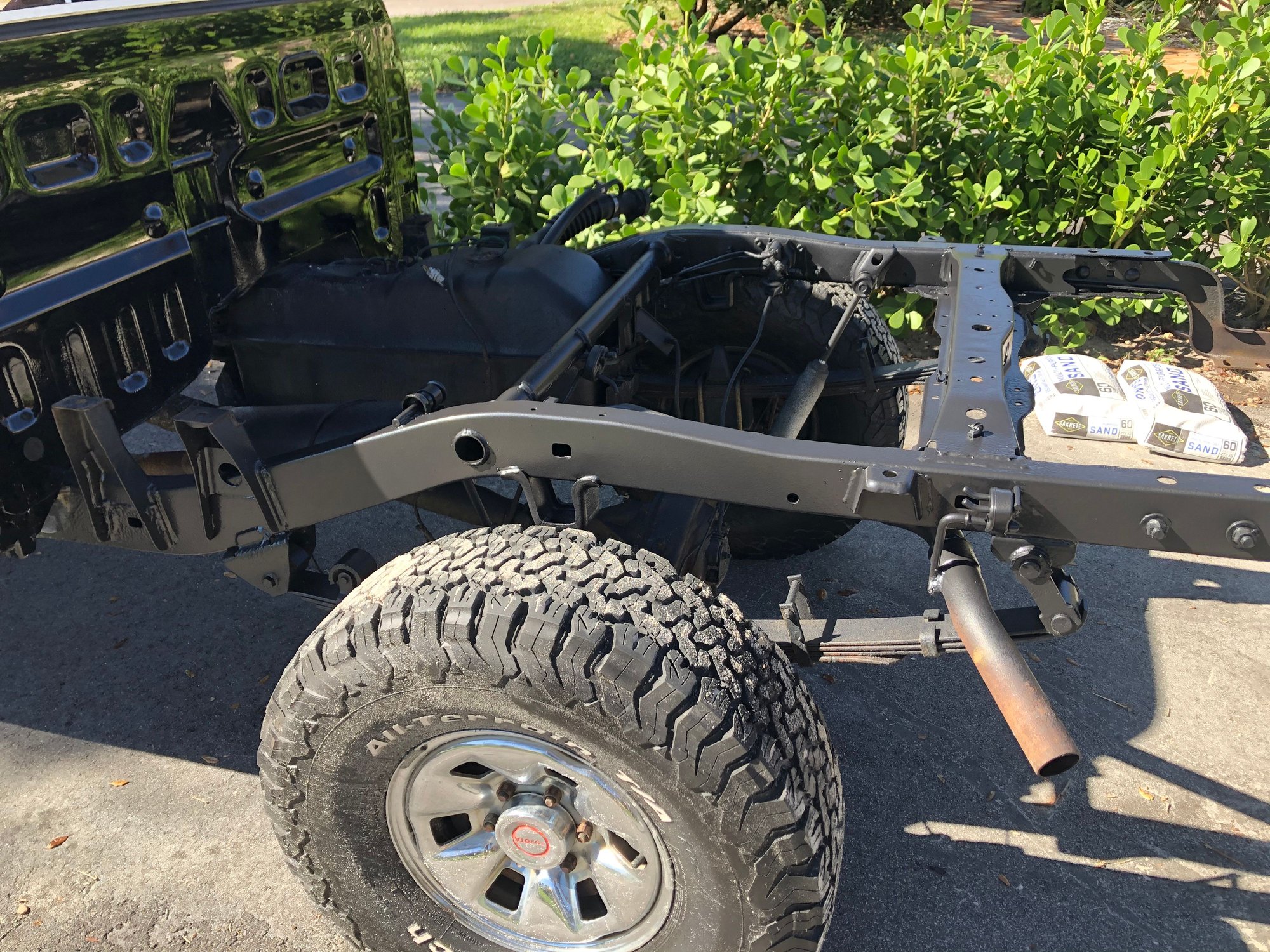

Word of advice, pick up a $20 sand blasting attachment for a pressure washer and do your frame. Once its dry skip the POR15, it really only encapsulates the rust and isnt UV resistent, you would still have rust issues underneath and still need to do a topcoat that is UV resistant, rubber undercoating I wouldnt recommend either. It works great until it dosent and starts trapping moisture rather than letting it breath. I did my bed frame rails and brought everything down to raw steel with my sand blaster and painted everything with 3-4 coats of "Steel-It" and it came out great. Thankfully my truck was a NC truck and is now in FL so it didnt see much in the way of salt but rusted pretty good like most of these trucks. You can pick up a new LSPV for about ~$200 from Toyota but most would recommend just hard-piping in a fixed proportioning valve and just deleting the OEM one.
https://steel-it.com/

Thanks for the input everyone. I'm committed to the POR 15 but will definitely re-think the rubber underspray. I've been using fluid film for a few years and do stand by it. One of the three owners before me did some kind of rubber undercoat I'm guessing at least a decade ago. It kept the front of the frame pristine and has worn off the back. The frame is in overall great condition, save a few spots, which was really encouraging. My engine only has ~103k and I'm planning on having it a while
I called TrailGear today, who referred me to one of their sister companies. The salesperson said that these would fit and the 4" offset is only 1/2" longer than OEM. Would this even be noticeable?
https://lowrangeoffroad.com/toyota-r...53=833&140=838
I also figured this would affect the LSPV (assuming I keep it) but I think there's room on the threaded rod that connects to the axle to compensate/adjust for the minor height difference of the shackles. Just got off the phone with the local Toyota dealer who's doing some "research" on pricing for a replacement LSPV and a few other odds and ends, including the shackles so how I proceed with a replacement/delete will probably depend on that.

Here are pics of my frame after I sand blasted and painted my frame with Steel-It.

Wow your frame looks amazing - Steel-IT seems great! I'm done with the POR15 and will post some pictures soon. I'm overall happy with how it came out and confident it will provide much better protection to the frame than before; definitely an improvement.

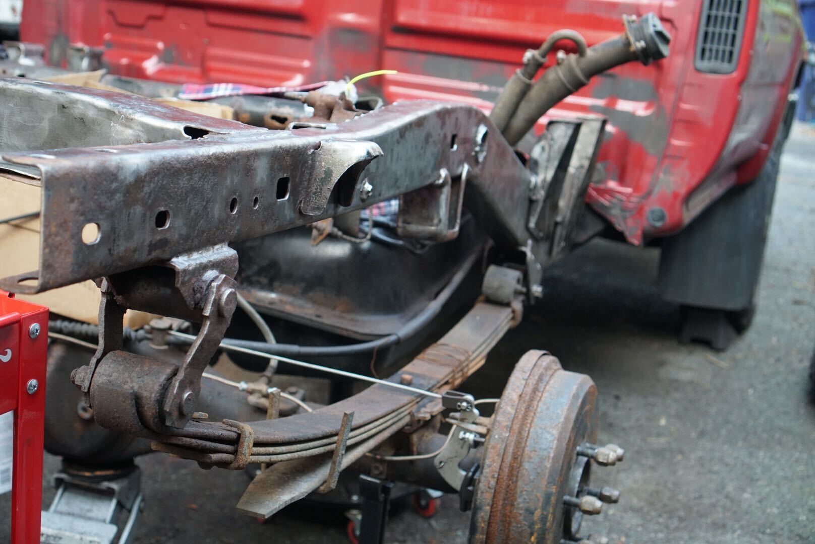

Okay so now for the springs.
1. Front leaf hanger bolt. The left one came out easily but I'm having trouble with the right. After some searching, this seems to be a pretty common problem. I don't really see why it should be so hard to remove seeing that it goes into the steel sleeve, rather than directly into the bushing and the left one came out in great shape. At any rate it's soaking in PB blaster and I'll keep working on it. In the mean time, I'm not sure what hanger bolts I should buy. I'm seeing a lot of 18mm "options" for the truck but the bolt I pulled out of the left is a 14mm diameter and 4" length. What's the deal with that? I don't really want to drill out the existing hanger holes since I would think that would compromise the strength then there's the matter of pressing out the sleeve from the spring. The one I puled out of the left looks like I could use it again - not sure how the right will be - or I could order from the dealer, but I'd rather have a greaseable one if possible.
Currently considering getting this: https://www.4wheelparts.com/p/warrio.../R-BKTR-90308A
2. I ended pulling the trigger on the 4" shackles from Low Range Offroad. Kicking myself since I ordered bushings from LCE but the shackles will come with them. Oh well.

Maybe the left side was removed so easy because it was the wrong Bolt
If your worried about drilling out the spring hanger simple to reinforce the back and front with the holes drilled you require and weld in place.
Unless your into quite a lot of jumping and hanging the axle in the air putting lots of strain and hard landings drilling the hanger to fit the correct size of your new springs
After my first all day adventure trying to remove the Spring Hanger bolts they seize to the steel sleeve I tried everything torch air hammer nothing worked
I just cut them off front and rear with a cut off disc pry the hanger apart enough and pop the Spring out I just buy the new bolts from my Dealer Hardware prices were not bad
I don`t mess with U-Bolts they get cutoff
Happy Suspension up grade.

The hanger bolts were stock and to be honest I'm not really sure what else you were trying to say in the last post. Ended up ordering replacement hanger bolts for ~$5/ea from the dealership. Once those and the shackles come in I should have all the hardware to bolt everything back together. Next up is the underside of the bed. I flipped it vertically to get a good look and am sure that I could spend another couple weeks on just that. I'm pretty sure the original owner must have sprayed a rubber undercoating on it out of the factory because under the coating the metal is perfect. Only the areas where it is coming off have bits of rust. For now I'm going to hit it with the power washer and the worse areas with the needle scaler, reinforce some of the metal areas around where the mudflaps bolt in and call it a day so I can get the truck back on the road. Maybe I'll revisit it next summer.
Here's where I'm at right now. I think I missed the sweet spot timing-wise for applying the second coat so it came out a little drippy in some areas which is a little annoying but overall I'm happy with it. For the center round bar, I punched out all the weak spots with the needler so it's got some holes in it now but is mechanically sound.

Oh also, after ~4 days of soaking with PB blaster, whacking with a hammer and hitting it with the impact, I finally got the right side leaf spring out without having to cut anything. Just takes a bit of patience and muscle
