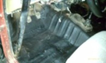

ouch looks like alot of work. when i got my truck it had a little puddle of water under the seats. i sanded it down, put bondo on a few little screw holes the previous owner made and then sprayed it with rubberized undercoat. if i could do it again i would probably go with the POR-15 that everyone raves about but i think i'll make it.
