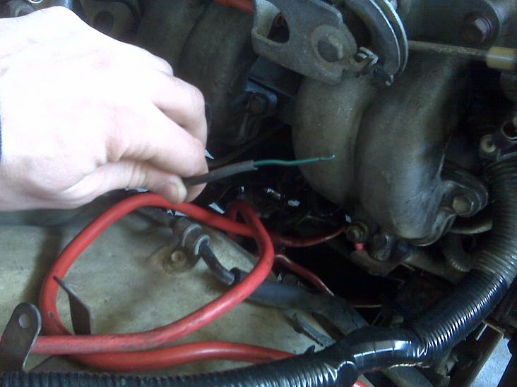

Ok I have an 86 4runner with 22re and auto tranny. I have found a random wire with no home. it comes out from under the plenum coming from the same section of harness as the fuel injectors and such. Anybody have a clue where it goes? Random green wire with black stripe all alone?

the only thing down there is the oil pressure sensor and the knock sensor
is your oil pressure gauge working?

Well i don't have an oil gauge. Just an oil light and as far as I know it works. Isn't the the oil temp sender near the oil filter? If thats the sender it has a wire connected to it. The knock sensor is in between the valve cover and the plenum right? If so then it also has a wire connected to it...?

Do you or have you had AC on this truck? It looks like it could be the AC clutch solenoid wire. It's in the right general area. Just a guess.

Just looked over a wiring diagram for 86 and it shows the green/black wire going to a simple water temperature switch (cold-grn/blk open, warms up- grn/blk grounded) but does not call out the function of the switch.

i have a 90 toy pickup regular cab 22re 5 speed. there are several unused plugs under the hood. toyota must have used the same wireing harness for muitlple models. some plugs are simply not used for some models

Toyota did use the same harness with all the plugs and what not regardless of options. I'm sure if you look around more you will find more "useless" plugs.
