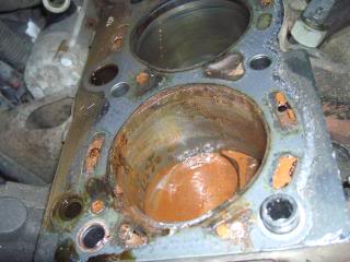

I'm not sold on that water injection stuff...mine ran like crap when it had water in it

Better luck next time you try parking in a lake. Honestly, what is clean rain water going to do in small volumes? Its going to go down the intake, into the cylinder's turn to steam and exit out. NO sensitive electronics, nothing to worry about. You might worry about cold shocking the metal, but I've never heard of rain causing any engine to crack.
