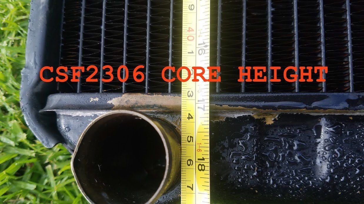

Buy Direct CSF 2314 or 2306 Depending On Core Height
You can buy direct from CSF.
CSF 2314 or 2306, depending on core height.
First-hand experience with both:
https://www.yotatech.com/forums/f116...l#post52450555
Ken at CSF HQ helped me identify exact fit for my truck and shroud, CSF2306
