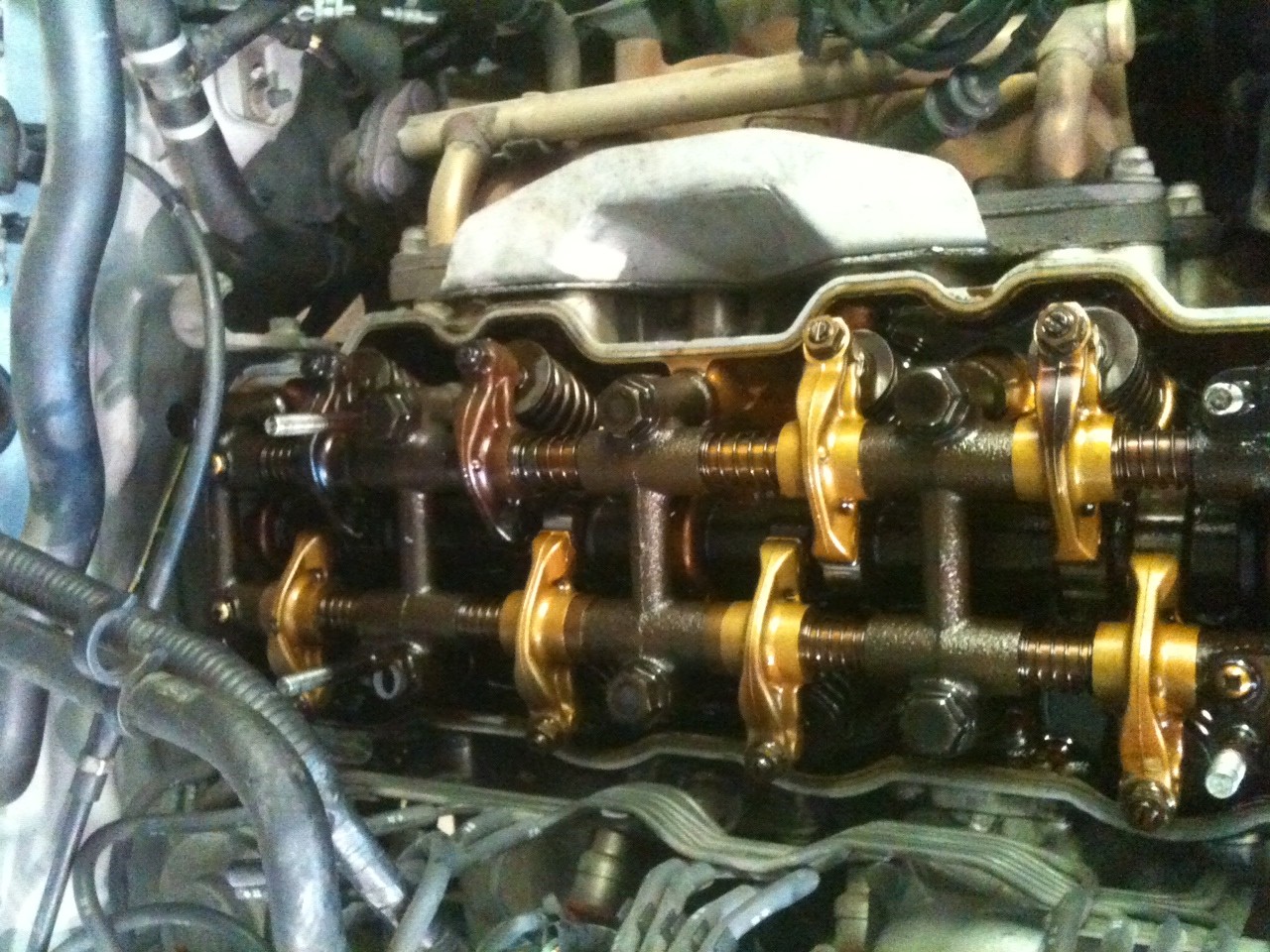

90 4runner 22re (All stock no mods) 4x4 5speed -- 190,000mi
So I took my truck in for an exhaust manifold leak--got that fixed--was missing a stud, manifold was not warped--new gasket sealed up fine.
However, the mechanic has informed me that the exhaust rockers on #'s 3 and 4 are shot, and that the loabs on the cam are worn.
He wants to replace the exhaust rocker shaft, the two rocker arms, and the cam. He is quoting me at $750 parts/labor.
What questions can I ask, to make sure this needs to be done?

don't just replace 1 or 2 rockers arms, replace them all, only use toyota OEM rocker arms with new toyota OEM adjuster nuts and screws. DO NOT use aftermarket, EB's 268 is a good cam.
Also looks to me both #4 intake and exhaust rockers overheated to me.
On a side note, changing the cam and rockers is easy. And can be done with the head on if careful. But since the head bolts have to come out it's very critical that the head does not move in the process.
You can't really tell from the picture if the cam and rockers are shot. If he's going soully on discoloration, then the parts might not be bad. If you still have the valve cover off, stick your finger down on the cam lobes for #3 and #4 exhaust. If they are still really smooth they might be okay.
Now the PO of my truck failed to adjust the valves and let them get way out of whack which caused my #4 intake to abuse the cam lobe, wear through the hardened finish, and wreck the cam and rocker. This was evident by a big rough flat spot on the pad of the rocker and all the shiny finish worn off the lobe of the cam.
On a side note, why are you replacing these? I know you said the mechanic says they're shot, but were you having a problem? Did you have trouble keeping the valves adjusted? Was there a valve clatter that you were trying to solve? Or is the mechanic trying to be pro-active?
When I did mine, to fix the fubar'd rocker and replace the cam with an EB Torkr, I disassembled the whole valve train assembly, cleaned everything and checked for wear. Since the only issue I had was the hard finish wore off and destroyed the one rocker I was able to replace just the one rocker, adjuster, and lock nut. YMMV. I you go that route, an adjuster, nut, and rocker should be less than $50. A cam from EB will set you back around $100 with shipping. I believe the headbolts are torque to yeild so they should be replaced = $100. Plus maybe 4-6 hours shop time.
As was mentioned above, you will be removing the headbolts to get to the cam and is crucial that the head doesn't move or break its seal with the block. If it does you are looking at a headgasket replacement and doing all the labor for this job again and then some.
If it were me looking to have this done, I would bite the bullet now and just have the head pulled, cleaned, decked, and reinstalled with a new head gasket. You might have another 4-6 hours of shop time invested if you go that route but you make sure that nothing else is wrong with the valves in question, by getting the head decked you boost compression which will give you more hp (believe me I noticed when I went from a decked head back to OE height when I replaced my head after the water pump went and I over heated), and you start fresh with all new parts.

He will ship a complete head, but you don't know if you need that yet. The head is seperate from the rocker assembly.
What your mechanic said was bad was this:
it is part of this:
which doesn't come with this:
it is part of this:

Not sure what to do next. Part of me wants to have him to close it all back up, and I will just pay for the manifold gasket and get the truck home, so that I can look at it, and figure out the next step.
Would it be worth it to ask for a compression test at this time, to get an idea of how the bottom end is holding up? I had read a few other threads where folks mentioned it is good to get a compression reading before tearing into the top end, so that you have an idea about how the lower end stands.
You could have a compression test done if you want. If your cylinders aren't within 10% of each other like they should be, are you going to have the bottom end rebuilt? If your answer is NO, then I wouldn't even bother. If your motor ran like garbage to the point of needing a rebuild, you rebuild it right? If your motor was running fine , a side from loud valves, the chance of having a bottom end issue are slim.

FOund a good thread on the process http://www.4x4wire.com/toyota/tech/camshaft/
Roommate said I could use her car for work, so that will take the time crunch out of it. I think trying this myself, as opposed to settling for a partial fix from the mechanic is the call.
I can't believe some of you think those two rockers could be good. If mine looked like that, they would be in the trash. They are obviously heat stressed.
replacing the whole rocker assembly is probably not needed, you won't know that till you get the rockers off the shaft. And as I had said before only use TOYOTA OEM rockers/adjusters. Not those ebay junk assemblies.
Talk to engnbldr he can explain why.
I never said use eBay, you're right they have a lot of junk out there. My pics are from LC Engineering, whom I would trust, I would also buy from RockAuto as long as you read that it is from a respectable supplier and not house stock, or some of the online Toyota Dealer Part programs.
