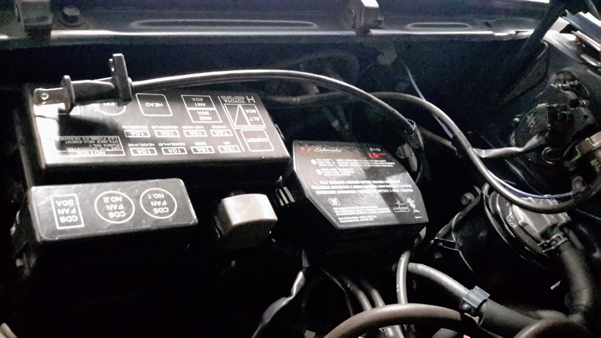

I have 2 vehicles that are often sitting idle for periods long enough to drain the battery. My solution was to install a smart battery maintainer in each vehicle that can be plugged in to a extension cord whenever required. I've attached a photo so you can see where it is in my '91 4Runner.
Jim
Schumacher SE-1-12S. Plug is usually tucked behind fuse box.

The Schumacher is a good idea. How long have you had it installed? Lost any batteries to over charging?
