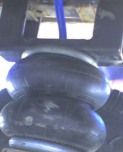

The bags I put in are 6" diameter, with an 8 inch height. Firestone industrial air springs part # w01-358-3400.
Total cost for this one is around the $600 CDN or so mark, here's the breakdown:
Bags: $250 (with the discount I got from work) Firestone industrial air springs
Bag Mounts: $170 (would have been cheaper if I would have used 2X4 inch
square tubing)
Welding: $100 including materials
Fittings and hose: $30 - 40
Portable Air Tank about $50 with other odds and ends for adapting
On with the Pictures:

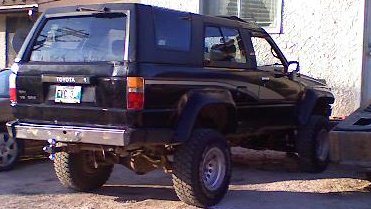

0419081041.jpg: Before the bags went in (morning of installation). I can carry both of those shrubs by myself, that's all that's in the truck. Can anyone say sagging leafs?
0419081911.jpg: After the bags went in and added about 30 lbs of air to each. I can drive around (on pavement in WINNIPEG) with 80 lbs worth to get a few more inches height. It's a really rough ride though.
img241.jpg: This is the air bag with the mount at the top. Still working on finding some steel tubing for the bottom though. At 35 lbs it's wedged tight enough it doesn't move.
