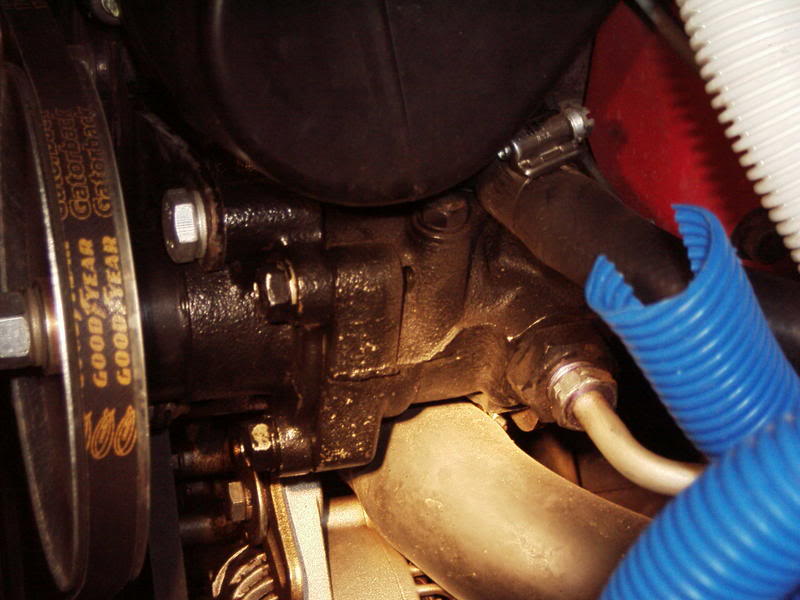

pic of 86 p.s
i hope this helps some , i know s couple are fuzzy but you still can get a look at the brackets ect...Name:  truck020.jpg
Size:  71.2 KBName:  truck024.jpg
Size:  64.4 KBName:  truck025.jpg

Thats one CLEAN engine bay! nice =)
