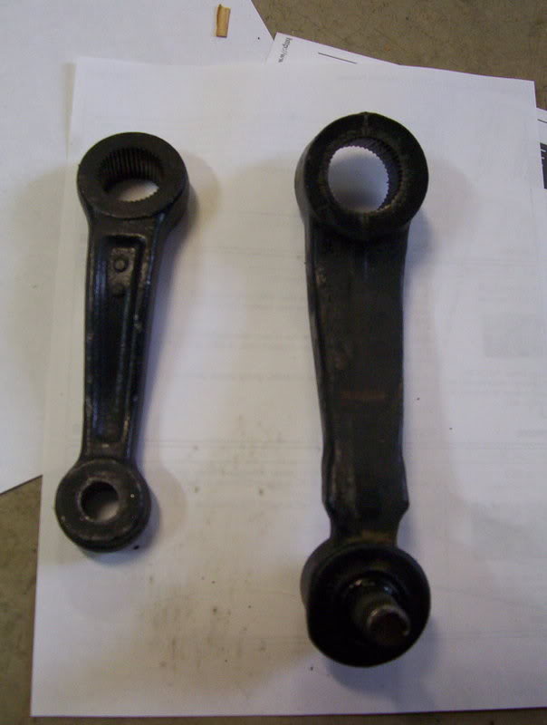

Really? I just tried going with a 2x4 power steering box and found that the pitman arm was too small to fit on the existing 4x4 equipment I already had.

could you replace the the 2wd pitman for one off a 4x4 and make it work? I think the boxes are still the same, maybe just the pitmans are different?

theres an alignment mark on the pitman arm to get it on the box correctly..
Negative.
Notice the overall size difference between the 2wd pitman arm and the 4wd pitman arm (the 4wd being the more robust of the two).
Now notice the size of the holes between the two:
4wd will not work with 2wd (as far as my parts show me).
