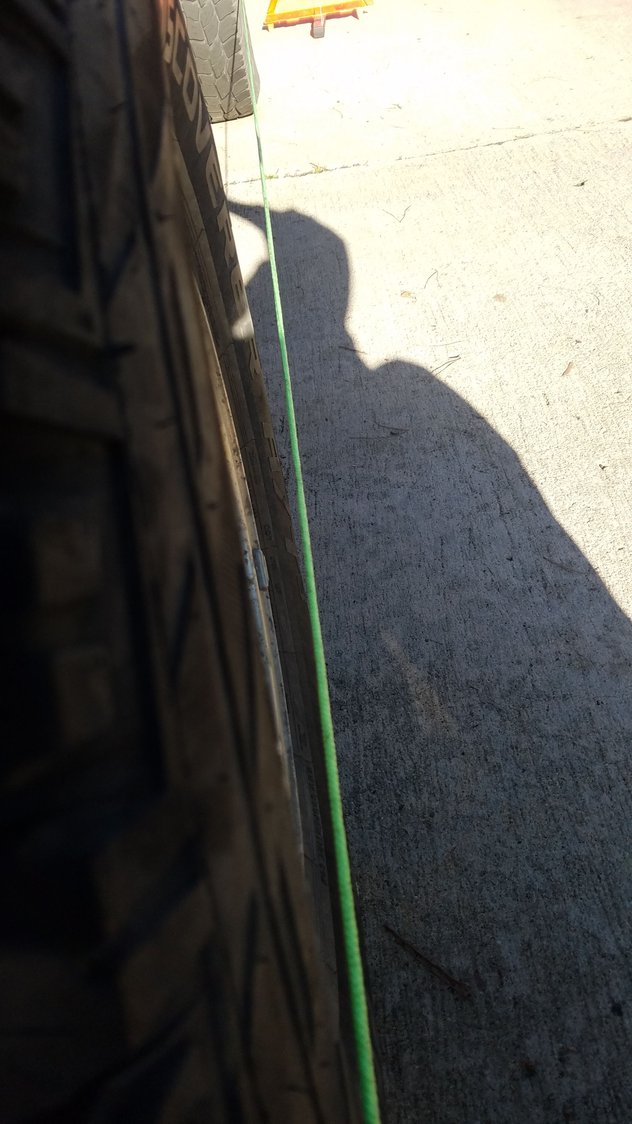

My steering wheel is on 12 o'clock "locked" position and wheels are as straight / symmetrical as possible.
Right Side
Left Side
