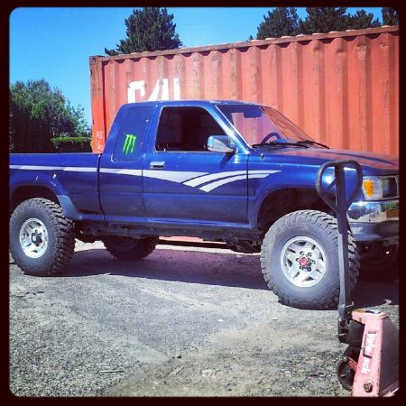

here's my 32x11.5x15's on a 5" lift, and they don't rub at all. but make sure your wheels have enough offset or else you will rub the tie-rod and I have stock gears,
a buddy of mine had 33's and a 4" lift and they fit nicely, and ran fine, slower than stock tires but not obscenely so

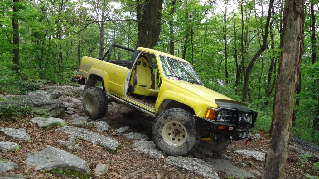

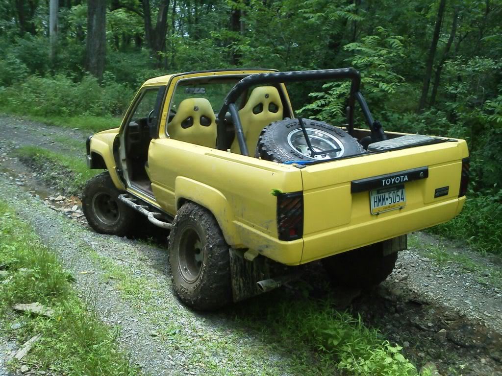

Not a pickup but same body/suspension, etc. 2" lift with 33x12.50's Chevy wheels so the backspacing was crazy. Only rubbed a slight bit on full stuff and full lock. The lift was BJ spacers up front and add a leafs in the rear.
I have a lot of pictures so if you want more just ask.

Ok 33's with a 2" lift aren't as bad as I though! Please post more pics and I'm assuming you have a 10 " wide rim, how far do the tires stick past your fenders ?

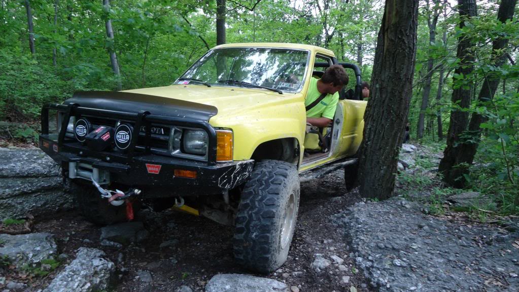

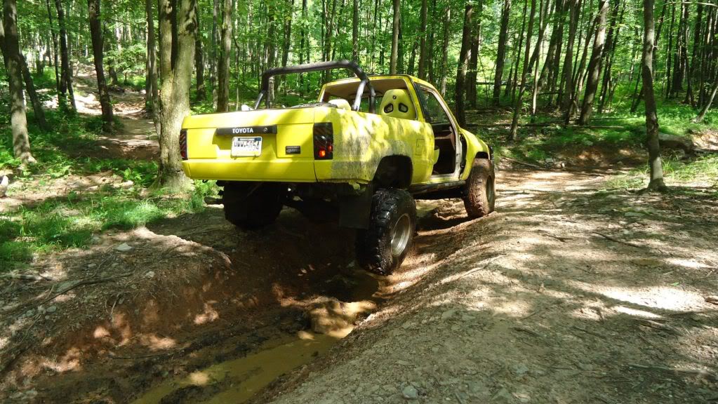

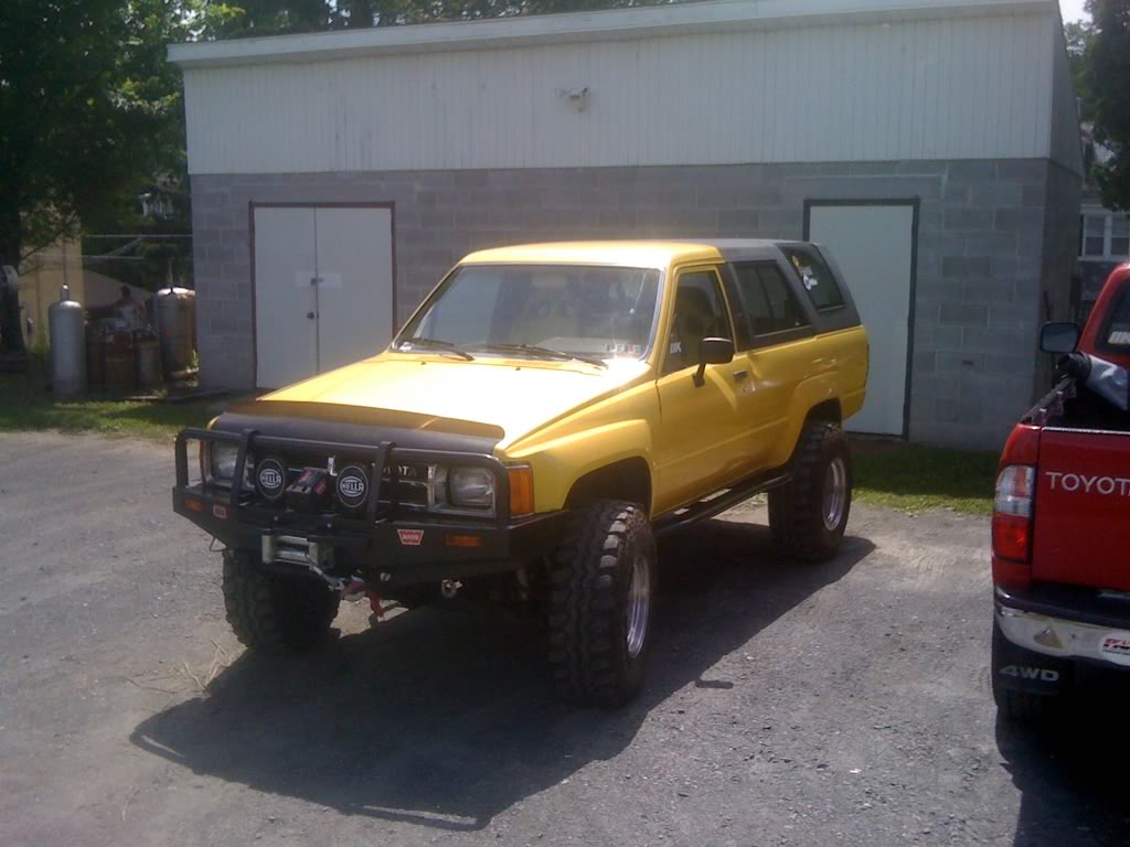

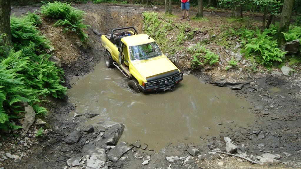

I sold this 4Runner in September of last year but let's see what I can remember. The tires stuck out far due to the wheels being the correct offset for a Chevy not a Toyota. They are 10" wide wheels. Let's see what other pics I can dig up.

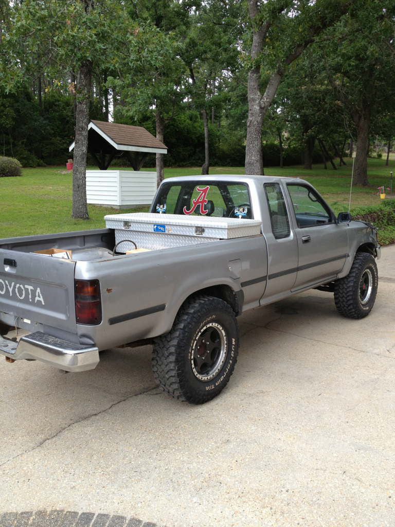

This is my 93 with 285/75r16 kinda like a 33 11.50 on 16x8 rims not sure of the offset.
No lift
