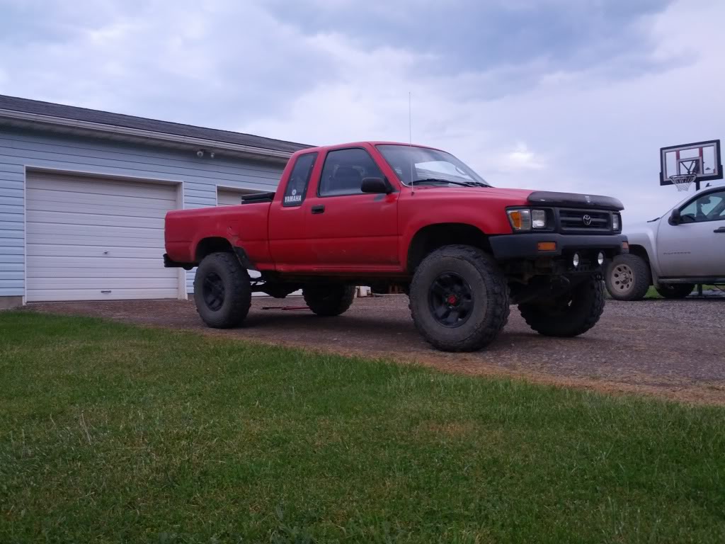

1.5" BJ spacers, 2" blocks, 33x10.50 TSL's

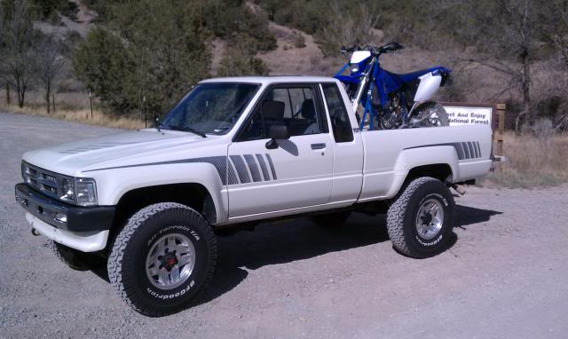

1.5" BJ spacers with relaxed T bars, 2" Downey rear springs, 1" 4Crawler body lift, 33x10.50 BFG AT. Sitting a little low in back because of the bike.

Nice WR!!! 450?

Thanks. 2003 WR250 with less than 1000 miles.

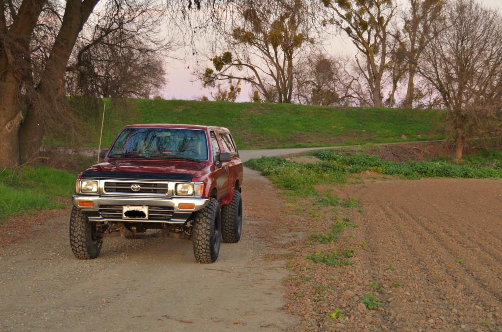

Here's my '92 22RE, stock front, 1.5 shackles rear, trimmed fenders, wheel spacers, 33x10.5's on SR5's

^^ nice truck and great picture.

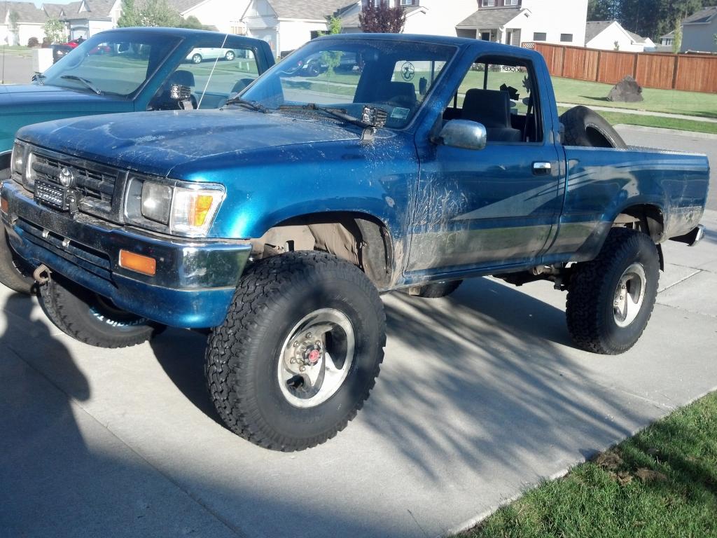

3" Ball joint spacers and a 2" AAL with 33x10.50's. Total of 5" lift from what I had.
Unless you touched your torsion bars, you didn't get 3" of lift from your ball joint spacers.
EDIT: How do you figure you have 5" of lift? You have 2" on the rear and 1.5" in the front (that's if you didn't touch your bj spacers). Unless you have a 3" body lift (I don't see anything in your sig that says if you do), you don't have a total of 5".

^um...show us these "3 inch BJ spacers".....pretty sure BJ spacers this tall don't exist and if they do they would be outright dangerous to run because of the leverage theyd put on everything. Perhaps you have 1.5-2" BJ spacers with some t-bar crank to net you 3" from where it was before? Same with AALs - 2" should only give you around 2" lift unless paired with shackles or blocks to go higher. Maybe you're just saying you're at 5" lift from previous state of typical saggy toyota suspension?
from the look of the picture that doesn't look very "5inch" to me... I have a 5" lift on my truck.
also i haven't seen 3" ball joint spacers... and agree that they would prob be impractical... do you have a link to how/where you bought them? or maybe a receipt?
was your truck lowered when you got it? if so then the 5" is believable if it wasn't stock to begin with. just curious
