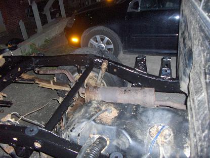

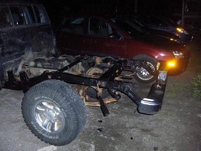

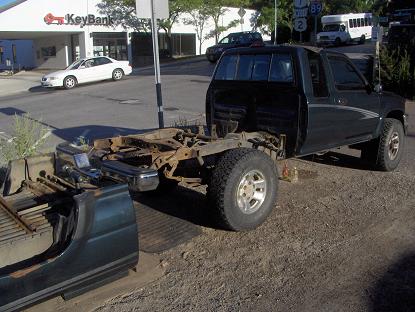

I took the bed off my truck and applied POR-15 to the frame, shackles, cross members and brackets. I did the three step process (marine clean, metal ready and por-15) and grinded down/ sanded the rust and metal down on all surfaces.
My bed is a little rusty too so I POR-15'd inside the wheel wells about 4 inches up and cut off the rotted sections behind each wheel. I also POR-15'd the structural components of the bed.
It was a days job, especially when you consider the time waiting after the metal ready was applied and after the first coat of POR15 (I put on two coats). I put it on liberally even though it goes on pretty thin. I used about 3/4 of the quart that I bought ($47 at bond auto paint division).
I had to cut 3 of the 8 bed bolts. It took two guys to lift the bed off but we needed a third to flip it onto the rails gently. putting back on took two guys and two girs.

finished project after second coat had some time to set up

Nice! I really want to do the same thing with my truck next summer. THough I need to cut out and weld in a new shock support..

I just cut off and repaired some rotten places in my frame. I am preparing to do the POR 15 thing too. It's great to see one done, nice job. Did you plan on doing the axel and leaves? How about the cab part of the chassis? DO you think one quart would do all of that too? How much marine clean and rust treatment did you use, if you did it again what might you do different (other than cutting the light wires)> Thanks a bunch, it looks awesome.
Old Sep 2, 2008 | 02:47 PM
vermontoyota's Avatar
Joined: Apr 2008
Posts: 238
From: Vermont
I did the pan underneath the gas tank and underneath the rocker panels too. I have no plans on doing the axels or leaves. T
he leaves are moving parts and show absolutly no signs of anything but surface rust. Plus- I plan to purchase new leaves in a couple years. The axel is in good shape too and I did not want to bind anything up (drain bolt, housing etc).
1 quart would probably be fine for the entire frame, 2 coats, and cross members. I plan to do the front sections of the frame, A arms, and inside front fenders this winter after hunting season.
I used standard bottles of marine clean and metal ready (20 oz???) and used roughly half of the marine clean and 1/4 of the metal ready.
If I could do anything differently I would wear the right size rubber gloves instead of size S (my gf is a nurse and we have a few boxes around the house) because they broke many times and I got POR15 on my hands which took a week to come off.
