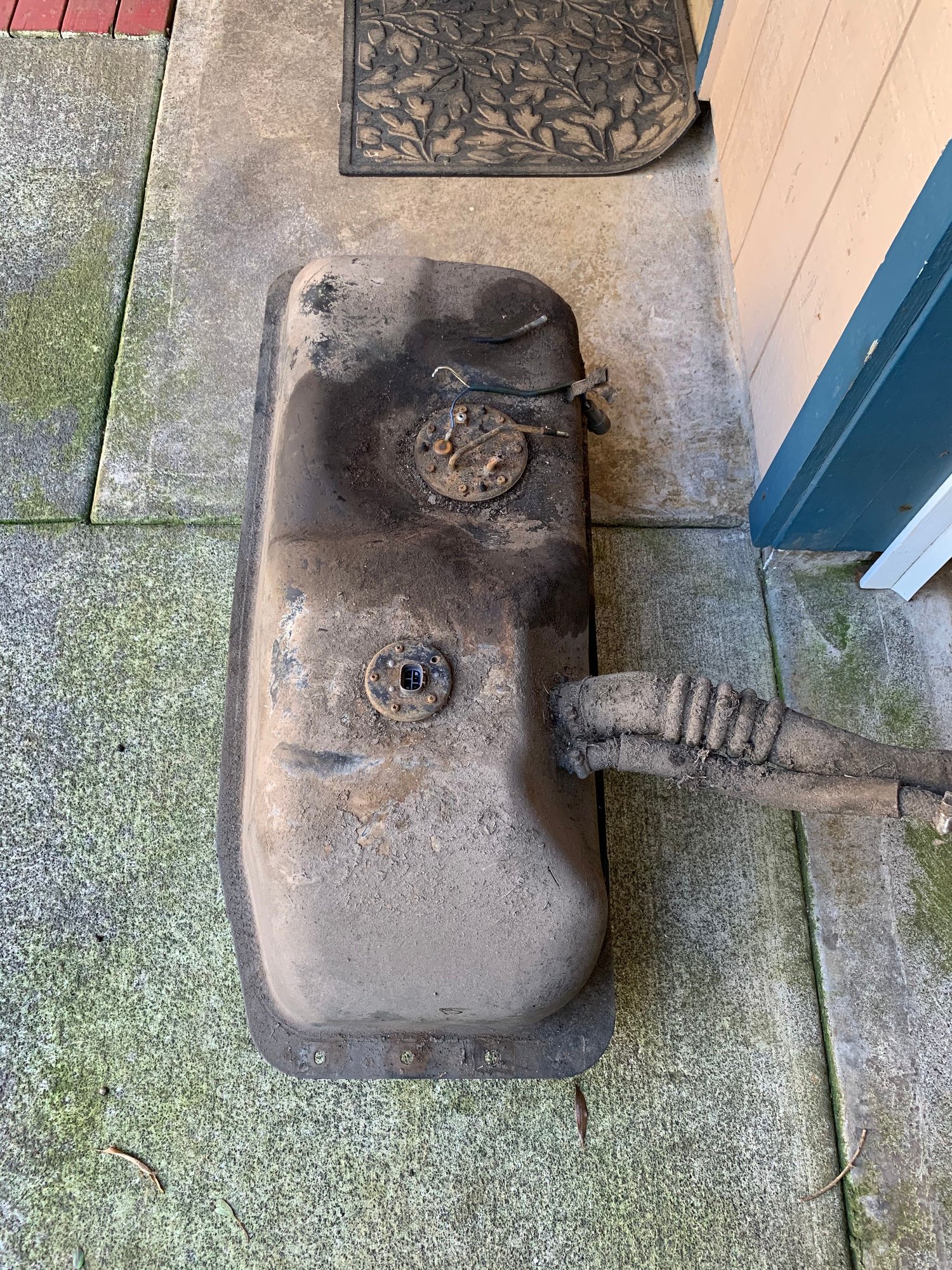

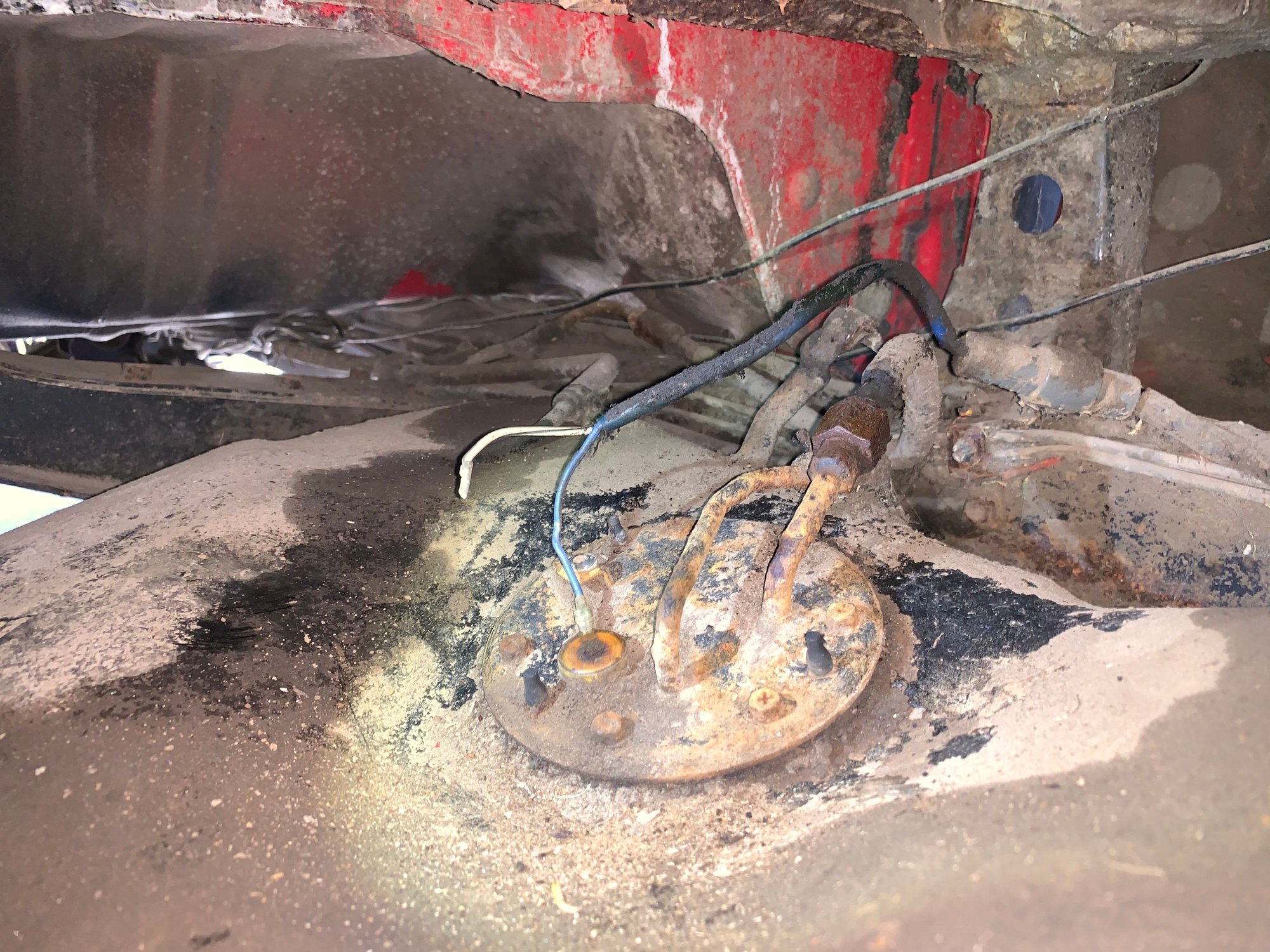

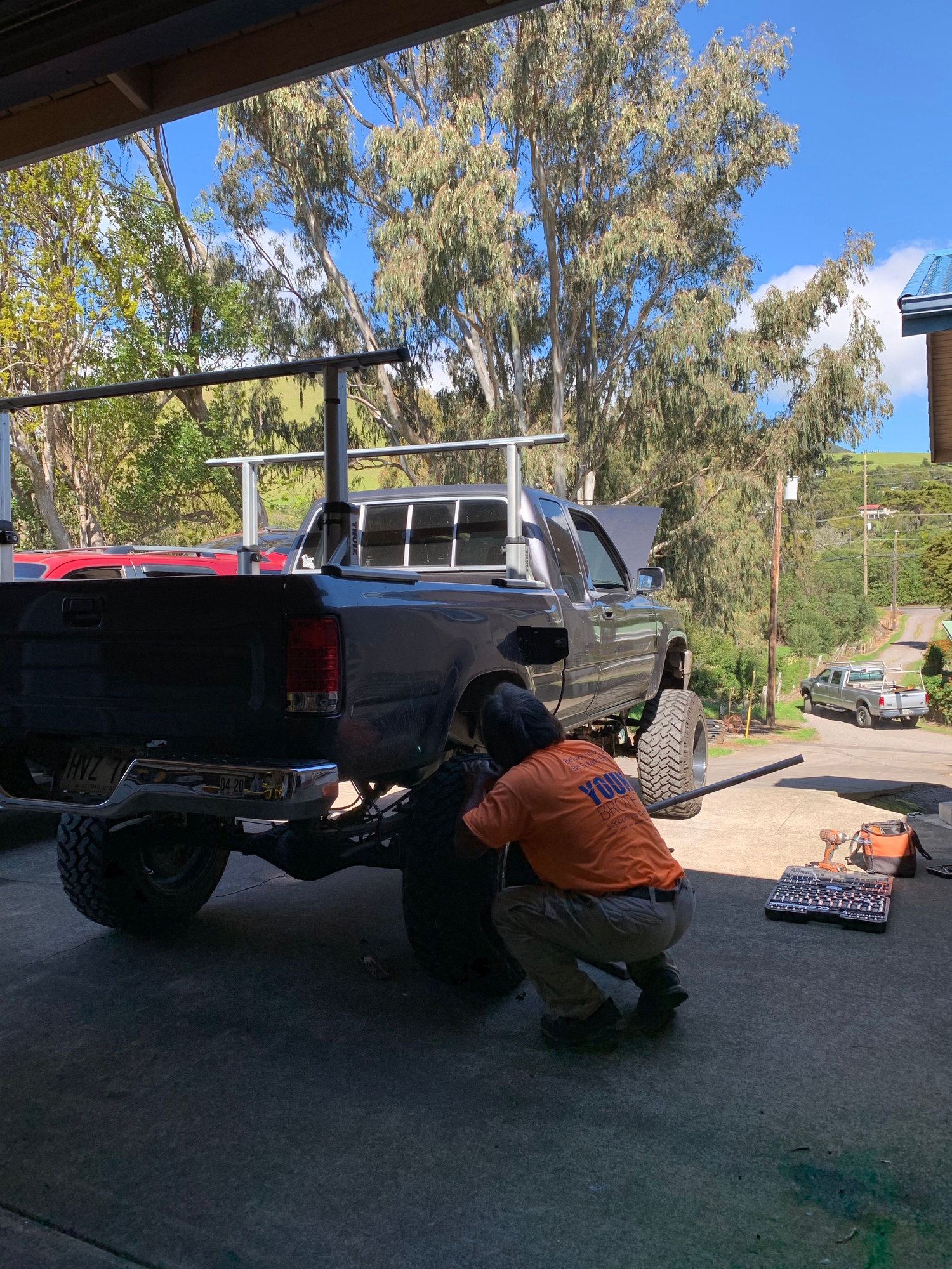

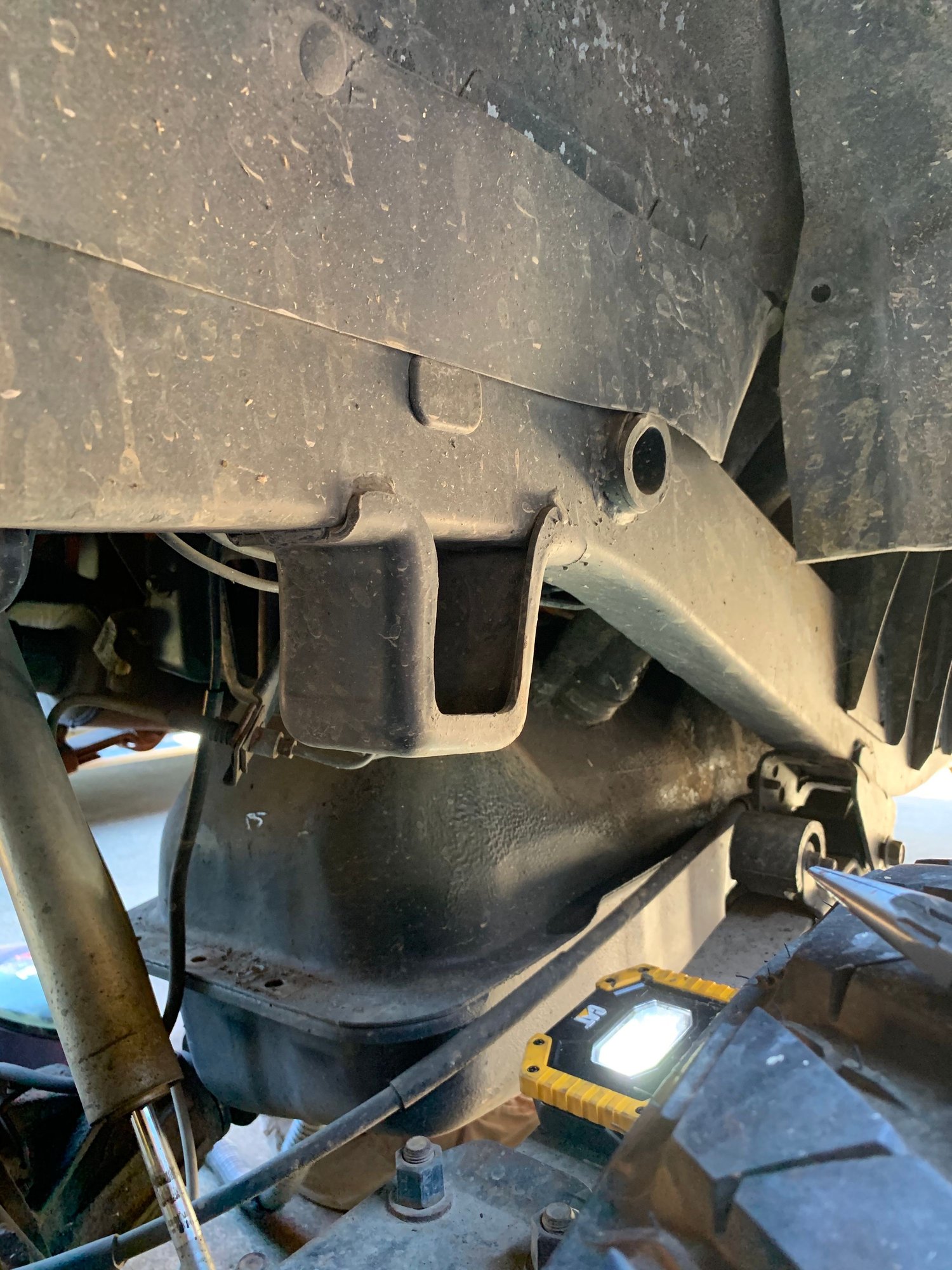

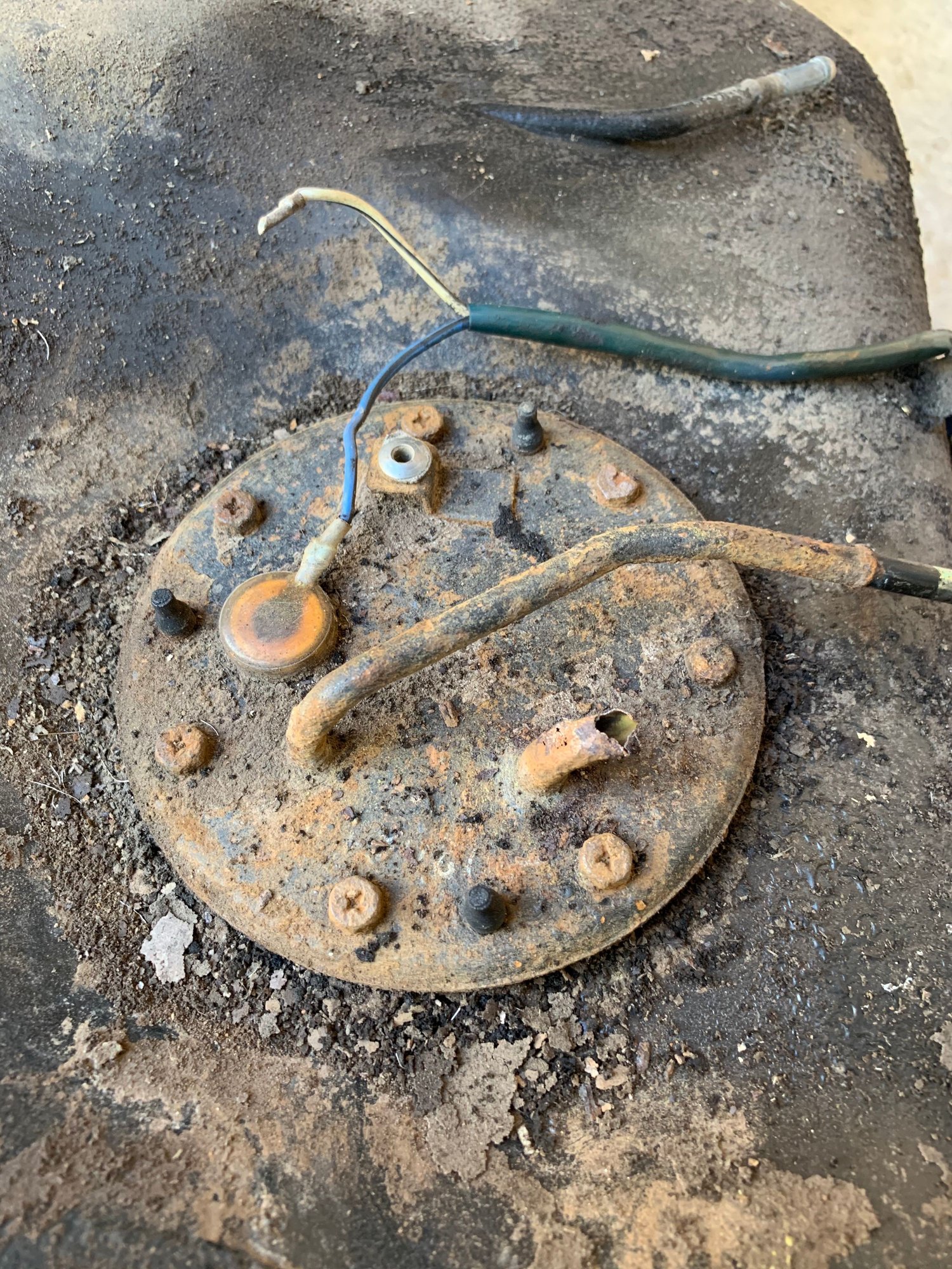

Update: Me and my pops finally had the time to get a closer look today!
We decided we wanted to drop the tank just a little so maybe we could pin point where exactly this mist was coming from. Not knowing what to expect we first unhooked the negative at the battery just in case, unscrewed the fuel filler spout, and then we took our floor jack and put it on two 4x6 blocks to get more height and then used a 2x6 on the jack's head itself to cover more surface area of the fuel tank. We unbolted the shield first and then the brackets that hold up the tank itself and slowly (VERY SLOWLY) started to release the jack and let the tank come down. Maybe 3 inches down we could just start to see the connections on the fuel pump bracket (which is what we were going for). We noticed that there were no hard lines other than the bracket itself. So we decided to drop the tank way lower, while watching everything very closely making sure not to break anything, so we can fully see everything. We couldn't quite see exactly where the hole was so we hooked the negative back up to the battery and gave her a quick turn of the key and then shut off (it was instant) to let the fuel run and see exactly where the hole was. FOUND IT! On the bracket there were two hard line coming off from it. So right then and there we knew we needed a new fuel pump bracket. However, my fuel tank was filthy and we decided since its so far down already, why don't we just drop it all the way out to check if the tank is still good so we can order a new tank all together if we find bad rust spots. So we dropped the tank all the way out, took a wire brush to the hard line with the hole to see if we could just clean it up a bit and possibly patch it temporarily because I also daily drive my truck. Found out that it was literally rusted out and actually the rust was the only thing holding it together. It ended up just snapped right off and we didn't go hard with the wire brush either so that was a wow moment. Its not pictured, but we cleaned up the tank and there's actually a few dime sized rust spots on the tank that aren't horrible but skeptical because they go deeper than the rest of the tank but also around the sending unit cap and the fuel pump bracket the necks that the gasket sit on were pretty rusty. I decided to go with a new tank just to be safe. Also if you look at that free dangling wire, that's the ground! it wasn't ever connected and my pump was still working. Thought that was pretty weird. So my truck is currently sitting in the driveway without a fuel tank and the parts search has begun. Finding everything easy but shipping to Hawaii is a nasty deduct outta the bank too so just seeing where is better on shipping.
I wanted to thank all of you again and this is my first time posting pics and an update so bare with me please. Install update to come. Wish me luck

Remove the fuel pump bracket and pump from the tank and you will see what I mean by repairing the existing tubes. I want to say from the factory the steel pipe is just brazed to the top plate. It would be a fast repair for now while you track down a new tank and bracket assembly. The underside of your truck is amazingly clean by the way. I am surprised that the bracket rusted out like that. Its very common to see on the East coast.
